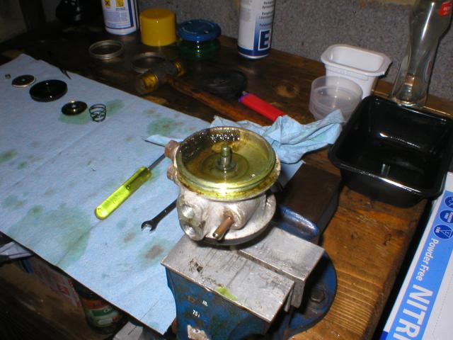

Generally, all that happens to height correctors is they get full of dirt and become sluggish in operation. Here's one that is typically mucky:Peter.N. wrote:I too would doubt that the height correctors need changing, I have one on an XM thats done getting on for 300,000 miles and although the suspension drops very quickly when you stop, all the while you are driving its OK. Spheres are about £22.00 each from GSF.
The muck has the effect of blocking the damper port, especially the graduated hole in the nylon plug. This makes the HC very slow to respond to moderate height changes and to not respond at all to small changes.
It's not hard to overhaul them and if you're careful you don't even need to replace the seals. Cleaning them makes one heck of a difference to response and comfort.
It's just getting them out and on the bench that can be difficult
Quick sinks can indeed be the front struts leaking. A test, although it means taking the strut top off, is to block the hole at the top of the piston rod (where fluid enters and leaves) and try pumping the strut up and down like a bicycle pump. If you feel little or no resistance, it's leaky. I've seen very high mileage ones with wear to the thrust sides of their pistons that cause a leak at the normal ride height area.

I'm about to do one Dom.. It'll appear on my website in due course...Dommo wrote:Do you have a guide on HC overhaulling/internal cleaning Jim?
It's prima-facie not difficult.
In the meantime have a look at the latest entry in my blog for a harrowing tale of woe concerning a height corrector overhaul on my Activa
That's when the job gets VERY difficult!!!

Here is my guide to rebuilding and overhauling height correctors...
Let me know of any errors/omissions...

Petrol's good but a tad smelly and flammable. Brake cleaner seems OK as a substitute... It doesn't appear to attack the rubber of the diaphragm, smells better and is not so dangerous... Secondly, I use it because it does not affect my breathing like petrol and white spirit does...
In a Xantia HC the nylon plug cannot be removed. It has a tiny tiny hole that acts as the damping element. In the BX and earlier height correctors there is a brass plug here and under the brass plug is a stack of discs that achieves the damping. These are absent in the Xantia variety...
There was a special tool for the brass plug and one can be made from a piece of suitable diameter pipe, a junior hacksaw and a file to make a key for it.

It's well hidden Dom and yes, off to one side in the rear of the front subframe. On the Activa it's hemmed in by the roll corrector.
Get right under and you'll see it sitting above a plate bolted between the front and rear rails of the rear of the subframe. In fact, the easiest is to eyeball the anti-roll bar, see the dogbone and follow it back to the height corrector...
The front height corrector has to be entirely removed for overhaul and on the Activa it's a seriously fiddly job...
EDIT: Dom, the picture on page one of my guide is of a front height corrector assembly complete....
