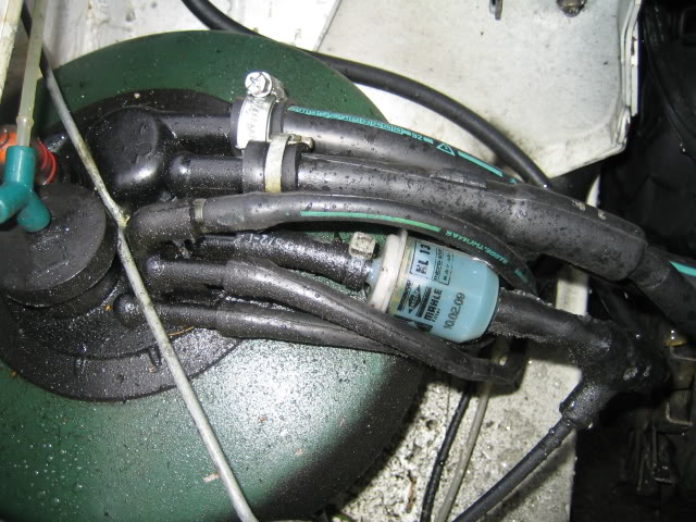

SwissSPEC wrote:I'll take a piccy at the weekend & post it up to show you the size of filter (i used a small one) & which pipe i attached it to.
Please do!
I will be Hydraflushing from about 9am tomorrow so I quite keen to do this as a mod myself.
Genius! :idea:

Unread post by SwissSPEC »
Here she, is in all her glory :D

Unread post by VertVega »
Thanks for the pic. Just as I imagined :)
So this filter doesn't block any return fluid into the LHM tank, except the particles.
Yes, that's the idea. Whilst the actual green lhm tank does store the crud at the bottom below the white disc, there must still be bits circulating round the system when the car is in use, so i thought the idea from another owner to fit a filter made sense. I haven't changed this one for a while, so once the weather warms up i'll take it out & take a picture of the inside to see if it caught much rubbish still floating around in the system. I'll probably empty the lhm tank as well & see how much brown mud is in the bottom (again i'll take a piccy for comparison purposes). This lot of lhm is the 1st i've put in after the hydraflushing, so it'll be interesting to see how clean the tank is.
Infact Andy at Westroen who changed some spheres for me recently commented on how clean the lhm was :D
