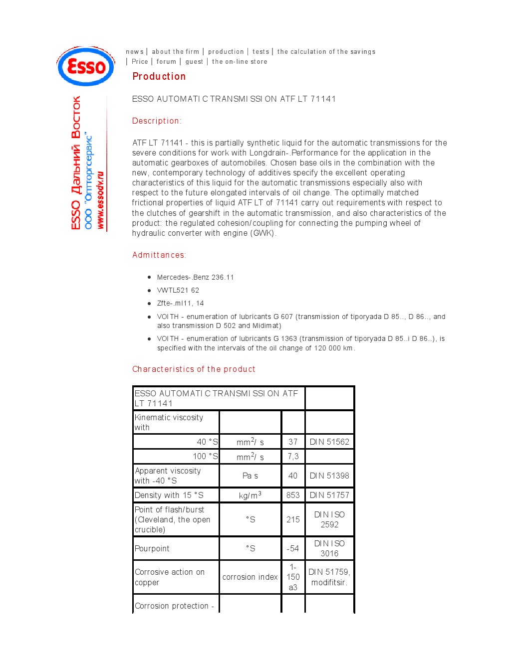

The TE-ML "approvals" they speak of are lists of required lubricants for various ZF products. The 4HP20 appears under TE-ML-11B and is a list of HP automatic Transmissions mainly.
Some do indeed use DEX II/III and in fact the 4HP20 is the only 4-speed ZF autobox that does NOT use DEX.
It clearly states that the 4HP20, along with the 5-speed autos use ZF Lifeguardfluid5 (ZF Part No. S671 090 170) and in the document, this cross-references to Citroen/Peugeot Part No. 1697 56 which is the AL4/4HP20 fluid and is in turn Esso/Mobil LT71141.
That is it. There is no other ATF suitable for the 4HP20. All the other part numbers in the list will just cross-reference back to LT71141.
I wonder if oil companies are making an assumption that all 4-speed ZF gearboxes use DEX and perhaps omit the detail that the 4HP20 is unique in that it does not.
Again, and I know we all say this until we're blue in the face, the ONLY ATF for the 4HP20 is LT71141. End of. Period. Full Stop. Debate Closed.
So yes, Valvoline (amongst many others) are being a little economical with the truth here...
And from your experience Toh, it would seem that DEX in a 4HP20 does indeed cause damage
:evil:
EDIT: Look at page 6 of TE-ML-11B and it is clear where the confusion comes in...
It is a list of 11B lubricants and NOT LT71141 equivalents. If you look at it quickly, it appears to be....

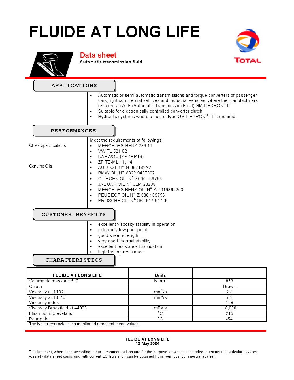

Valvoline are making a very clear claim there that the stuff is compatible with LT71141 but I remain very suspicious.
Why, for instance, do they not quote the Citroen/Peugeot approvals and why do they not quote ZF TE-ML-11 whereas Esso do? ZF TE-ML 14B, 16C and 17C have nothing to do with HP series gearboxes...
I remain firmly convinced that Valvoline are being a little lenient with the truth here...

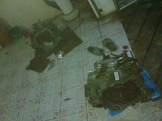

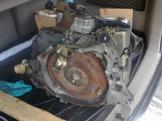

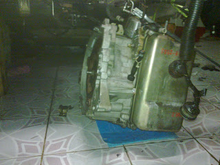

i bought the used 4HP20 from scrap yard
its cost 17 000 thai baht. including ECU and tourque.
now my PUG on the Road again. Thank Jim, Thank Frenchcarforum

Good to hear this has worked out well Toh :) . I was following it with interest (although I was unable to post anything helpful) :) , although I did notice a redish trace in the stripped box (and thought that the correct fluid is golden)

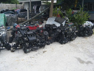

its mileage around 40 000 km, the seller said.
they bought a completed car in Japan, drove to dismantle place and shipping to Thailand.
