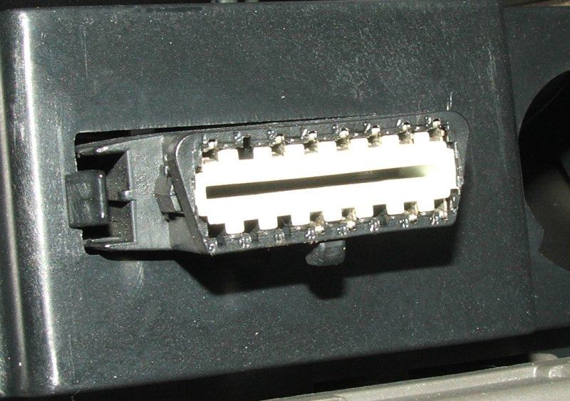

Jim I have a misfire thats noticeable when accelerating. When I checked with Citroen they looked up my car and said it defo has an OBD2 connector. It looks like one too ?
does a Lexia work on these ?
