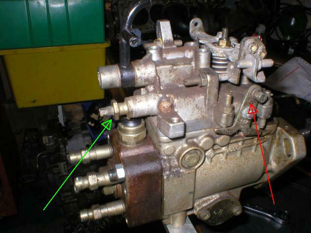

Kev,
I've been giving this issue some thought. The fact the engine starts OK is good.
First test is to see if the idle speed increases when you move the fast idle lever, the one indicated by the red arrow in the picture. If the speed rises then good.
Now, when you had the pump apart and you removed the throttle lever, did you mark the position on this so that it went back on the throttle shaft inc EXACTLY the same position? I normally scribe a line across the lever to like up with the slot in the top of the threaded part of the shaft. If it's even a couple of teeth out, the rev range will be compromised.
If you did not mark and are not sure if the lever and shaft are correctly aligned, Remove the lever and start up. With the lever off, try turning the shaft (now free to go anywhere) and see if the engine will rev. If it does, that was the problem. Replace the lever so that the engine is idling as the lever sits against the idle stop screw and immediately revs as the lever is moved. When doing this take care as the engine may over-rev if you go too mad at it...
If that draws a blank, did you disturb the setting of the maximum delivery screw (green arrow in picture)?
This setting is very critical and if badly maladjusted will prevent the governor operating at all and idle is all you'll get. To adjust, very slowly adjust until the engine will just red-line at full throttle, no more.

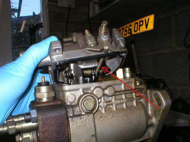

If it still won't rev and the fast idle lever makes no difference, did you get the fast idle spring reconnected when replacing the lid? It's the spring shown by the arrow in the photo below..
