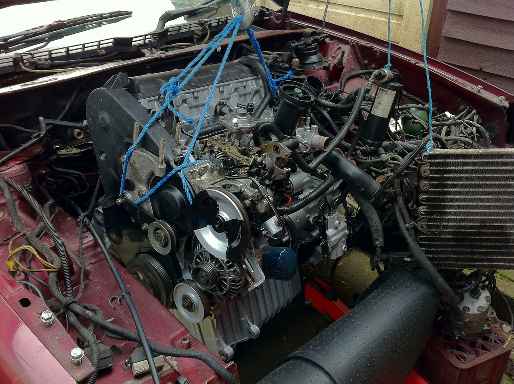

After the recent Bank Holidays and good weather, more progress has been made on the XM.
At this stage the new the timing parts have been fitted and the engine rotated several times to check that nothing clashes and the timing pins can go back in. I also used this to prime the oil pump/system.
After the engine was in location I spun it over for a few seconds without the injectors fitted to pump some oil around it. Threading the main loom took some time to get right because I wanted it to go in the tidiest locations that wouldn't risk chafing. Self amalgamating tape has been used to bind up any exposed wires and openings where the loom exits the flexible plastic conduit.

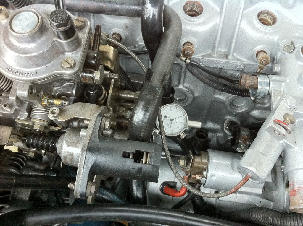

I finally found my dial test gauge so had to strip some parts back off the engine to allow it to fit. This isn't something I've tried to do before so I've got my fingers crossed.
Steve.

The spigot and spline areas in photo: The best stuff to put on those areas is Rocol or Molyslip ASP paste. The Rocol is £ouch. I have the Molyslip with 60% molybdenum in it.

Well the attempts to start the engine didn't work. Basic checks seemed to indicate that no fuel was being delivered to the injectors. Due to a urge to get things moving I swapped out the injection pump from the one off the spare engine I bought. I set this up using the dial gauge. After a bit of cranking the injector pipes started to leak fuel (I'd left them loose to enable them to prime). Tightening up the pipes allowed the engine to start but boy is it rough and smokey. The engine was only run for a few seconds because it's cooling system is still in bits.
It could be that the reason for the rough running is that the hydraulic tappets haven't yet filled with oil. During the rebuild I squeezed out all I could or I've made a mess of the timing. So rebuilding continues.
