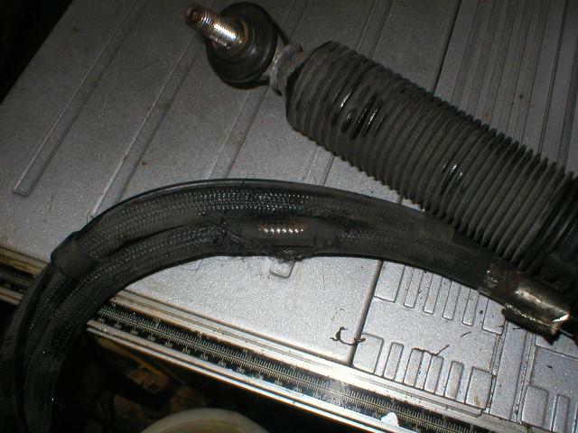

That's a good point Kev. There's a heck of a pressure in those hoses so I'd expect a split to eject LHM in a fierce jet rather than a dribble but if it's not quite gone all the way through it will seep. Seen that on the rubber section of a damaged power steering pipe.
The ram flexi hoses are two hoses in one with the lower layer separated by a steel braid.
There is a real risk of abrasion of the front ram hoses if they're not properly laid.
This picture is typical of the abrasion wear. It shows the internal steel braiding. I caught it before it sprang a leak...

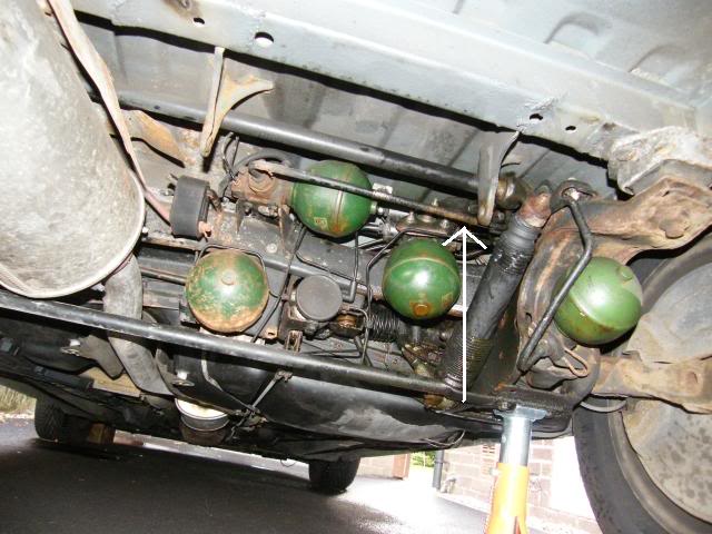

The first sign of the leak is LHM pouring from an electrical conduit behind the Activa pipe where the arrow is in the pic below:
I'm sure it's a leak on the electrovalve, or else a hole in one of the pipes to it.
It seems pretty clear from this arrangement how the Activa system was very much an afterthought! How much simpler would it be if the Activa and Hydractive valves were swapped? :?

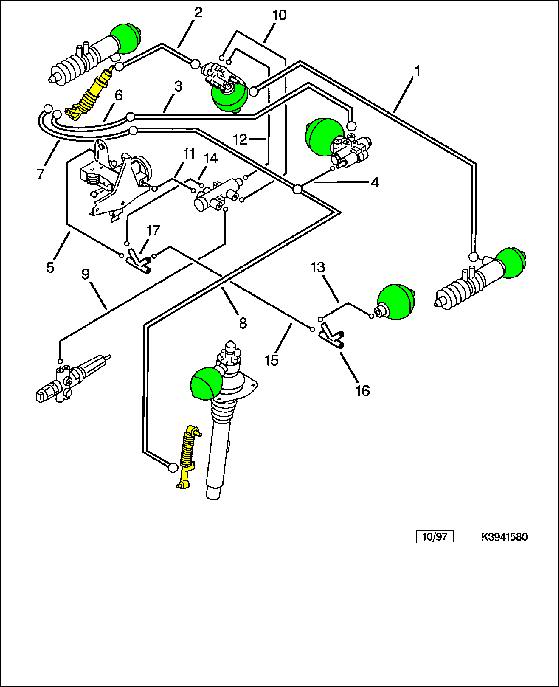

This image shows the rear hydraulics of the Activa.
The pipes on the hydractive block are 1&2 for the feeds to the struts. 10&12 are small bore pipes from the anti sink valve. The only pipe not shown is the rubber return pipe.
The two ram hozes are 6&7.
I'd be inclined to strip out the hydractive block assembly and take a look at all the stuff in that area. I've done this once already on my Activa and it was reasonably straight forward. Where abouts are you? If you were in my town I'd pop around and get under there with you.
Cheers, Kev

The arrow points directly to the area of the ram pipe unions.
Just above here is a 5-way junction that carries the cylinder returns. Activa electrovalve return and the ram return. It does not carry the hydractive electriovalve return.
It can split.

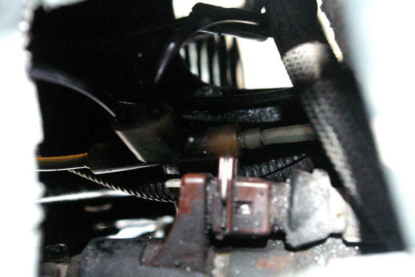

Here's a picture of it showing it's proximity to the hydractive electrovalve. The shot is not an arty vignette, it was taken through a hole in the floor that was cut for easy access.
Seems a tin opener is a useful tool to have with an Activa :lol: :lol:

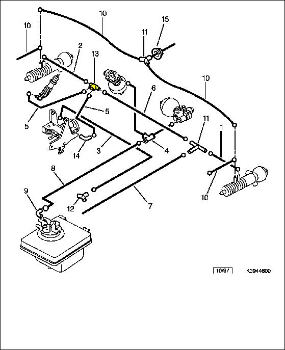

Here's the layout of the rear return pipes:-
Cheers, Kev

Jim, that return union looks to be in the perfect position for the leak! But not in the perfect position to fix. (I like your arty photo BTW! :D ) Why on earth did they put it there?!

I have to confess, James, it was not my photo. It was taken by someone who had a similar issue to you but in his case it turned out to be a split half-way along the hydractive valve return pipe, near the middle of the subframe.
