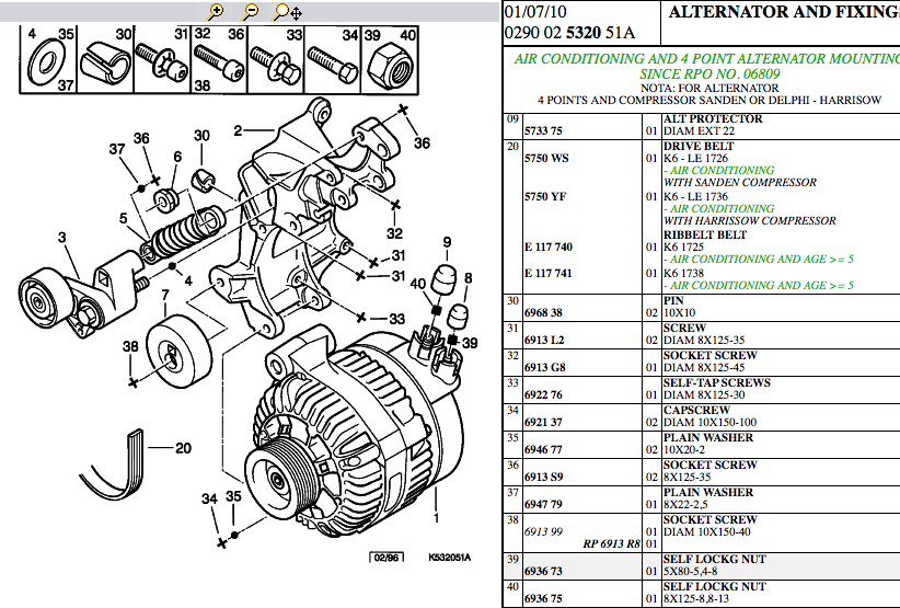

Are you after bolt 36 that runs through the end of the spring?
I'm pretty certain these bolts crop up again and again throughout the
bodyshell as I had a load in the pot from stripping down a Xant estate
a short while back - there were quite a significant number.
Not 100% certain which part of the car though sorry but I'd try the handles
above the doors in the headlining first - one of these can lend a bolt until
more serious kit is fixed.

my deliverd Eurocarparts original peugeot/citroen (xantia/C5) tensioner arrived with the removeable roller, held in place with a thick elastic band
I am not sure which tensioner you were looking at without the roller included. there is only one washer needed to hold the roller in against the threaded hole on the tensioner as the diagram above shows, unless you
mean the top mounting hole on the tensioner and not the bottom.
