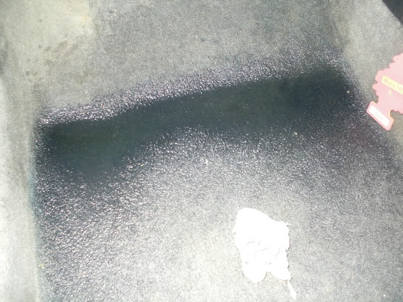

After mopping out as much of the water from the footwell last night, I was surprised to see this much had escaped from just warming it up.

I had a similar leak on my MK1 from the scuttle, easily remedied though which begs the question why it isn't refitted properly in the first place.
