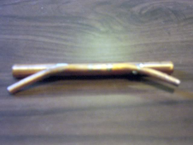

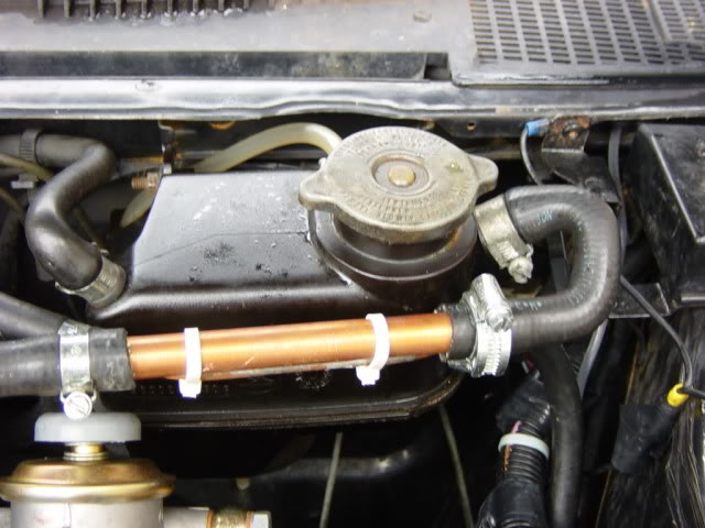

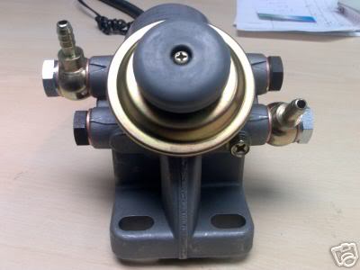

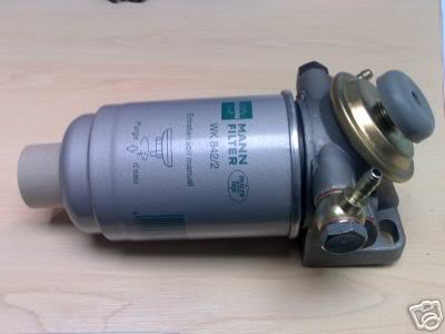

Ok, if it helps:
On my 205 I had the 'back of block' fuel heater. This caused endless air problems so I bypassed it. The filter was a stand alone unit with no heating and that also had air problems.
As I could not fit the type you have (its a long story but on an XUD7 in a 205 / 309 you cannot fit that type of filter if you have an oil cooler fitted to the oil filter due to no hoses being suitable) , I'll spare you the details.
Anyway, I brought this from Ebay :
From 'dieselman' from what I remember, sells a fair bit of useful stuff.
I then needed some heating, so I made this from two copper pipes, just soldered together:
You'll notice the fuel line and the coolant line is the feed out of the top of the thermostat housing to the expansion bottle, as this always circulates coolant.
It's a bit tidier now, that was during my initial experiments. I only use derv btw, but needed some heating for winter obviously.
Maybe this idea is some help to you, although the positioning of stuff is obviously different.
I'm just posting this as hoping to throw a few ideas your way.

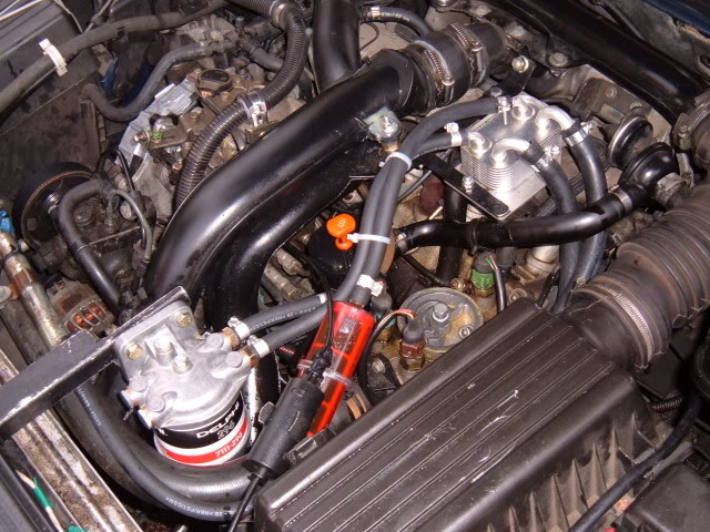

Right Ive decided to give the old xantia filter housing one more try so Ive stumbled across a website that sells viton O-ring seals.
the size of the bottom seal is outside dia-73mm internal diameter-65mm and 3mm across. the sizes are shown on the diagram Andy posted earlier in this thread (Thanks Andy).
the only one I can find onlne is 4mm across but I reckon it will fit with a squeeze and the extra ml might make for a closer fit.
the website for the viton o-rings is www.altecweb.com point your Mouse pointer to hardware for a link to o-rings.
regards Nigel.

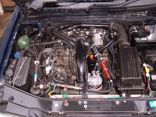

Right I seem to have made a reasonable temporary repair
of the air bubble problem in the XUD fuel filter, firstly I
removed the filter housing cleaned it up with petrol and
turned it upside down, I then filled the outer groove that
the orriginal oil seal sits in with epoxy resin glue and then
I sat a 4mm profile o-ring on top of the epoxy glue, now I
know what your thinking the 4mm profile is far to big for
the slot in the bottom of the filter housing to fit properly
esspecially as the orriginal seal has a profile of 2.5mm.
I waited for the epoxy to start to set and turned the
housing the right way up and bolted it back on the
thermostat housing in the car the glue oozed out of
the sides as I clamped the filter housing down.
I primed the fuel line and still saw some bubbles
in the line when I started the engine, but not so
many so I took the car for 70mph run up the a14
and stopped in a layby to check for bubbles and it
seems to have cleared the problem, the 4mm
profile seal fixes the housing more rigidly to the
thermostat housing as there is no play if you try
to rock the fuel filter housing from sided to side,
do this with the old 2.5mm profile seal and it moves quite a lot.
I'm still not convinced that the air problem will
be gone and stay gone for good so I have ordered
a new filter assembly from www.ssldieselparts.co.uk
the nice man will buil;d your filter to your requirements
over the phone and all for the princly sum of £20
depending on which filter you buy.
citroen wanted £67+vat, I know therte is a heat
exchanger under the orriginal filyter housing but
being as I have a flat plate heat exchanger already
I can route the heated fuel through the new unheated
filter housing. provided I install a pre-filter to filter the
fuel before it reaches the FPHE.
it seems that the only place to retro-fit a different filter
housing on my xantia is behind and just below my air
filter box on a bracket hanging over the gearbox.
I hope that the above infor helps someone with at least
a temporary fix to stop air getting to their XUD fuel pump.
oh & Xac according to the www.vegetableoildiesel.co.uk/forum
website their are quite a few people that have modified
their xud engine cars with retro-fitted filter housings
because the veg oil and bio-diesel eats the seals
eventually, so for your information I am not Unique
it just happened to me before it happens to you
and i found a cheaper way to fix it than entertain
citroen at ludicrous prices.
I did try two second hand housings from a scrappy
but it didnt work the air bubbles kept on comming
through the fuel line.
regards Nigel.

Edit to add: And Thanks "Steve" for adding these pictures.
this is what I have decided to do about the air leaks in the xud filter,
I have completely removed the xud filter housing as I couldnt cure the air leaks.
I bought this delphi un-heated unit for £17.00 and connected it to my
flat plate heat exchanger,
(it is possible to buy a glowplug heater for this filter) as you can
see space under the bonnet is at a premium so a bracket
had to be made to hold the new filter in place, total cost including
hose clips and new fuel line £25.00.
if I had bought the citroen xud filter new it would have cost me
£67 +vat just for the new xud housing. the new filter cartridges
incidentially cost £2 each about the same as an xud filter.

Photos of retro-fitted filter unit to 1998 xantia diesel.
myGlaren put the piccs above up for me to show people where it is possible to fit a different filter to an xantia saving quite a bit of money on the actual filter housing.
thanks again steve.
