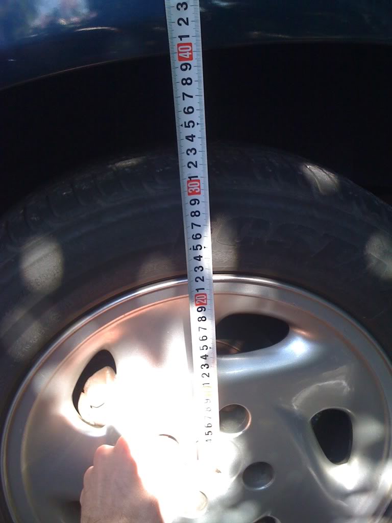

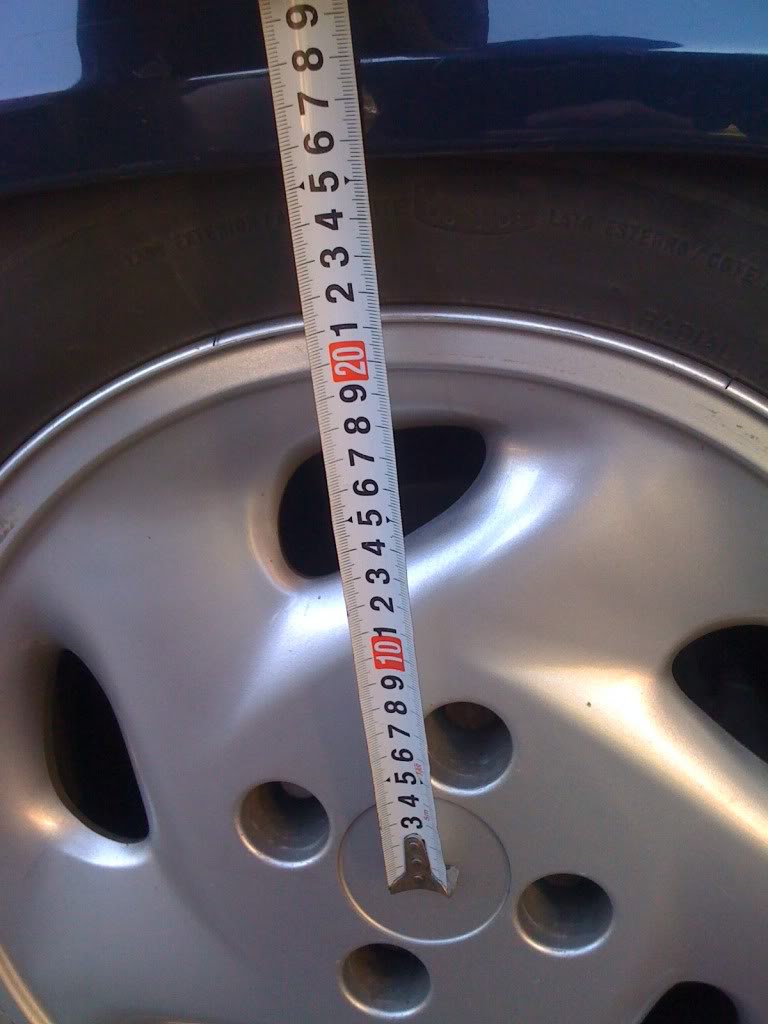

I've just measured the distances between the centre of the wheel and the wheel arches, and on the front the distance is near enough identical +/- a few mms. The rear however... The nearside is a whole 5.5-6 CM (!!) lower than the offside!
Could it be that someones fitted the wrong rear shock/strut to the car at some point? Or it's just broken??
'Limp' nearside rear corner?

Thanks for the replies chaps.
My drive is sloped, but unfortunatly my Activa has these same symptoms whether the car is facing up or down the drive, and also on the flat. I went to Aldi on friday and it's a level car park, and it's very noticable that the car is leaning at the rear towards the nearside (lower on the nearside)
Me and my dad had a look under the car yesterday, it does look as though the nearside strut (what the corner sphere attaches to) is cleaner (and newer?) than the offside one. Could it be the wrong strut? Is there such thing as a wrong strut that could cause this effect?
If so, does anyone have a nearside rear strut for an Activa?
Thanks!

Hi Jim.
Is this the National Rally you mentioned?
http://www.nationalroadrally.co.uk/2010/index.php
If so I won't be able to make it, my final university exam is on the 5th July so I'll need to be doing a lot of revising that week!
I had noticed that helping the car lower at the back seems to work, the sitting in the boot idea seemed to work well enough but I wasn't sure whether this was the norm, so I guess it is! I just wondered whether it was the Activa system saying no and keeping the rear end in the air but obviously not.
My drive is on the wonk both side to side and front to back so the nearside front is at the lowest point, but I've tried pointing the car both up and down the drive so nearside front is at the highest point too, and both times the nearside rear is quite far into it's travel. I even noticed it at my local Aldi car park which is near enough flat, I'd parked up, noticed it was leaning to the nearside at the rear, and sure enough when I came out 15 minutes later it was still leaning. I've got some photos of the rear wheels on service high and service low with a tape measure against them that I'll post up shortly.
It handles well enough to me, but I've not drive another Activa to be able to comment. The car does seem to be quite bouncy when the anti roll system is tight, around 90 degree corners on bumpy country lanes for example, the car will bounce - whicih makes me think the Activa balancing spheres need replacing relatively soon. But if the rear end is leaning to one side, and the engine continues being awful on fuel, I can't really afford new spheres, until my degree is done anyway..

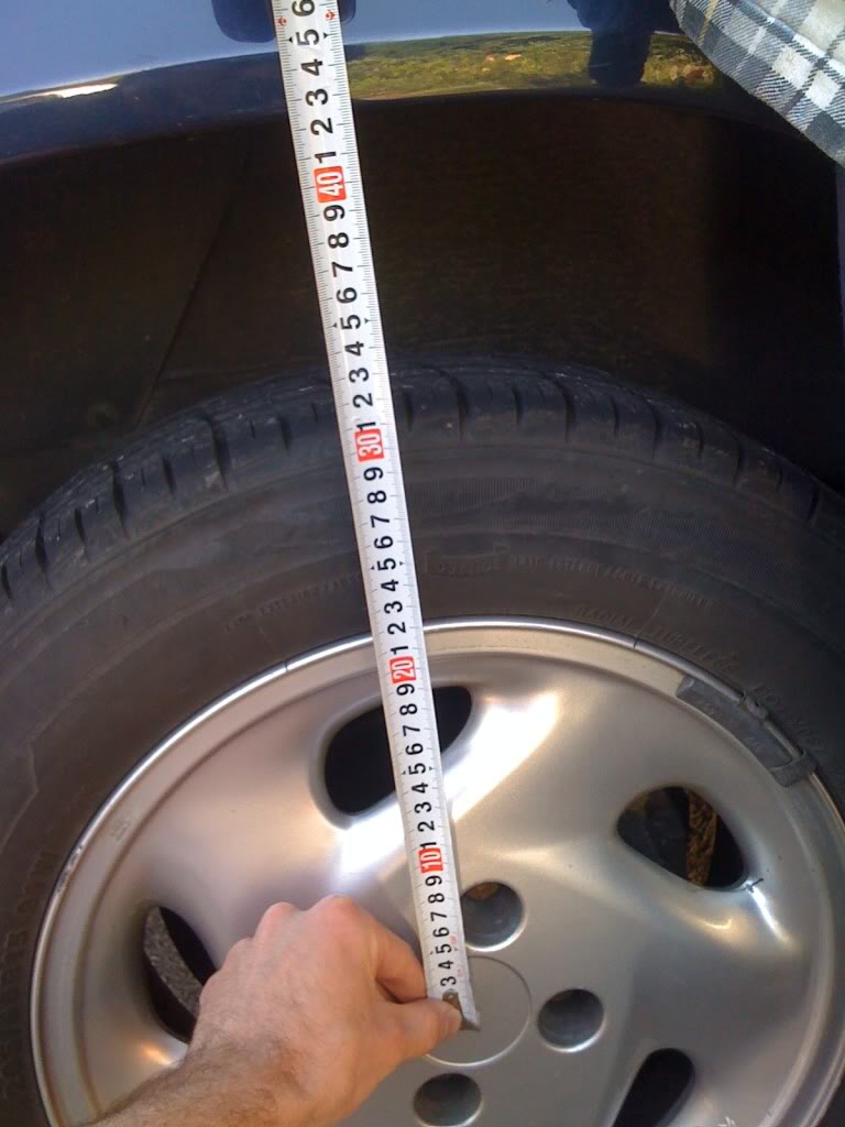

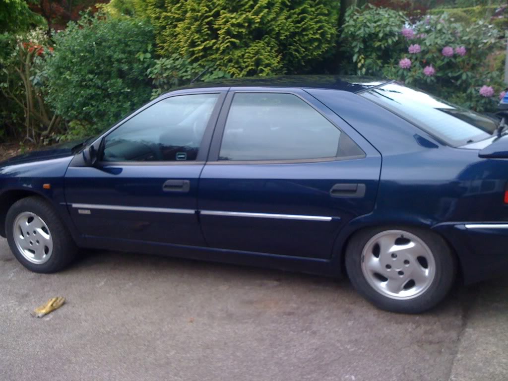

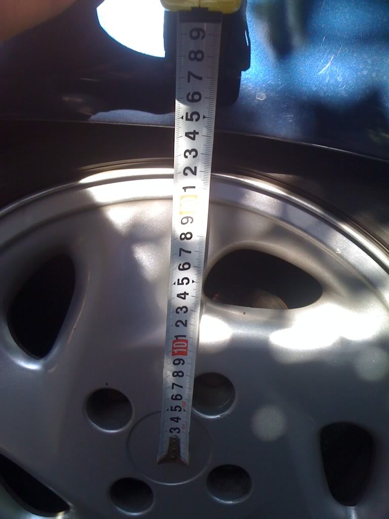

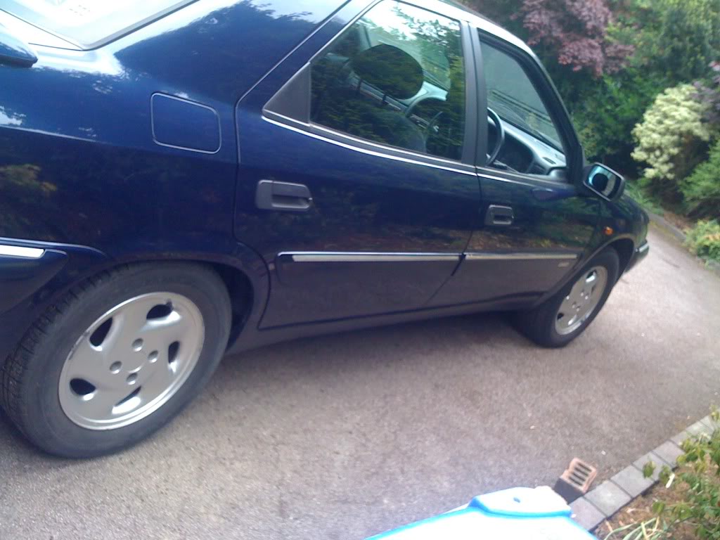

Shortly he says...
Nearside rear on service high:
Offside rear on service high:
Nearside rear on service low:
Offside rear on service low:
And here is the car from a distance, sorry about the different camera angles, but you can see the normal ride height of the nearside rear is significantly lower than it should be:
And the offside:
And the offside:
