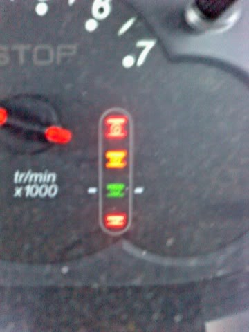

Electrical?????
http://www3.snapfish.co.uk/snapfishuk/s ... 3303367010
It happened on way home tonight. However, I am beginning to think it could be electrical.
Yes the car seems to rise slightly at the front when driving and goes up and down more than usual when sitting.
However I noticed the lights and beeps came on just after I switched lights on.
Then I noticed the lights on dash, as in the picture above, had disappeared after I switched lights off. (I never saw them go off at the same time) and the level indicator returned to the normal green position.
Anyway as an experiment, when I drove up my road, I switched the lights on again and BEEP BEEP BEEP, the levels lights came back on.
Now if it is electrical could it affect heights and cause the suspension movement I experienced?
Also, have car booked into dealer (sigh) for tomorrow, just trying to get transport to Aberdeen. An idea of what you guys think re this would be helpful as I like to go in to these guys armed with at least some knowledge, given past eperiences.
Incidentally the buzzy thingie on the top right of engine bay still...err buzzes. Not usre if this could be related. Would put photos up but as you see I have forgotten how to and it's in a precious post titled "Name that tune", if I recall.
