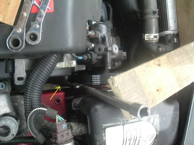

Mike,you trying to give me a heart attack? lol. I've not touched the timing,and i've run it with the belt off,hopefully the aux belt has nowt to do with the timing!
citroenxm wrote:FIRST Test, take the Aux belt off, then run the engine again.. If it has stopped then its the crank pully.. A very common failure item on HDi's
Paul
Paul,have you got this the wrong way round :wink:
Right, i eventually got the belt off.Bottom tensioner went with a right crack,with a bar on the 8 mill allen key. Swivelled it upwards and could just about slide the belt off the small bottom tensioner. Looks like it's gonna be real tight getting it back on,if i just reverse the same proceedure.
Ran the engine beltless. Noise gone. So it can't be the bottom pulley can it? it's the only one 'in the loop'.
So it's got to be on the belt 'loop'. All seem ok,alternater,top roller etc,but, what's the large item right of the bottom tensioner? The wide middle,grooved part spins ok,but it's end can move,and make..metaly noises!
anyway,bit of a breakthrough: The small bottom tensioner in my pic spins ok,but, it has some lateral play in it, and if i grab it at the bottom and wiggle it,like checking a wheel bearing, my original metallic hammering sound is almost replicated :D
Got to be that isn't it. 40 odd quid at Gsf,none on 'the bay'.Wonder if it's worth checking the scrappers.I'll replace the belt,9 quid at Gsf.
Oh and yes,the bottom pulley is the rubber sandwich type.Seems ok.

HDI Dave
Posts: 333
Joined: 14 May 2009, 11:20
x 3
Unread post by HDI Dave »
:? :? Car's driving me nuts :lolhit:
1./ All systems connected = loud hammering (like with a small hammer)
2./ Belt off,ie,just the crank pulley spinning = Quiet...ish
3./ New bottom tensioner:
http://cgi.ebay.co.uk/ws/eBayISAPI.dll? ... 0640170790
and belt back on = ..................hammering again :roll:
4./ Drove the car 10 miles,in short bursts, with it hammering. Then it stopped doing it. Drove for another 10 miles ish,still quiet. Hmm. Ran it today with the plastic cover off,in the drive = quiet. Put the air con on and my hammering reappears :shock:
New belt was a pig to get on,was a tad smaller than the old one..stretchage,with age? Top tensioner was also a joy...NOT!!!
RichardW - Thanks for the link/tip..guess what, I dug out my ratchet spanners...and 15 and 16 mill one's gone awol! haha,typical...
Rigged up a bodge - a flat 15mm spanner can just fit on the pulley nut, then a long sosket extension fits nicely into the 16mill other end of the spanner. Then there's enough leverage to force the tensioner back,towards the windscreen,and wedge it with a piece of wood...oh well,should make it easier next time i whip the belt off :P
Pulley? It looks as old as methusala,but i can't find any drastic play in it.
