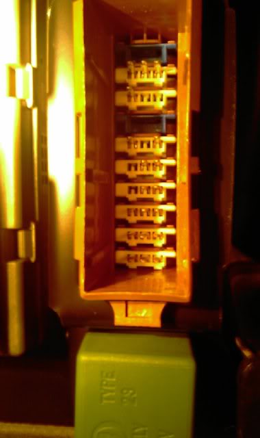

Hi,
The connector looks like it should have 10x3 pins, so must be the old version!
The green temperature sensor was replaced with a new one by the garage, i never asked them if it improved anything or if they checked....
I will ask them what kit they use to check it, and see if they have a Lexia.
Thanks
Steven
Thanks
Steven

If you can get to Kent I have the adaptor for the old plugs, Im a new Lexia user but would be happy to plug it in and see whats going on.
