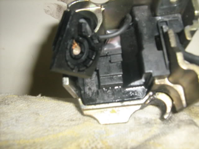

Hi CoXen and Malcolm
Is it like this immob from my pump
The immo is fitted inside the armour and the black connecotr fits onto the solenoid.
Kenny
Kenny

yes Kenny that is the same imobaliser on both the pumps James has, the one on the car and the pug replacement, on his pug pump which is of the car w3hen we de/armoured it the black cap came away leaving the metal push fir colar on the solenoid, so we can reuse that as we just cut the wire as it goes into the electricery,
regards malcolm

Yes, Malcolm thats what I've done on my pump.
