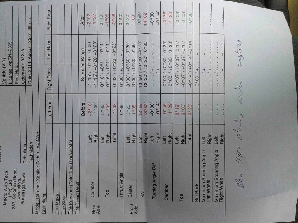

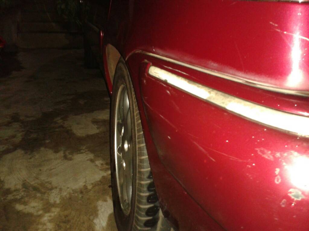

Hi. In my Xantia the inner side of the tyres are wearing. When I see from behind the wheels are lean outwards. But there is no noise coming and no bearing play as well. Anyway when inspect the alloys, there is a dimple in each of the wheels which I think the car must have gone over a hump may be at higher speed. Can the subframe get de aligned due to a shock like that. The car has done only 93000kms. The results sheet of the wheel alignment is attached.
Regards
Chetiya.
Regards
Chetiya.

it is very very unlikely a bump can cause one or both wheels to lean out,
when the arm bearing fail it in not always posible to feel any play/movment in the arms, as tghe anti roll bar is bolted directly onto both arms with no link rods,
also they do not alway make any noise,
im sure both you trailing arms have got bearings colapsing

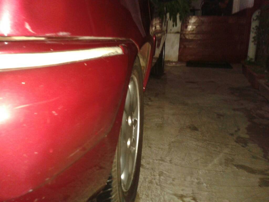

Many thanks Citronut. There is another matter. When I measure the hight from the ground up to the mud guard edge, the right side is about 1 inch lower than the left. Also the wheels have moved towards left side. Can the subframe move.

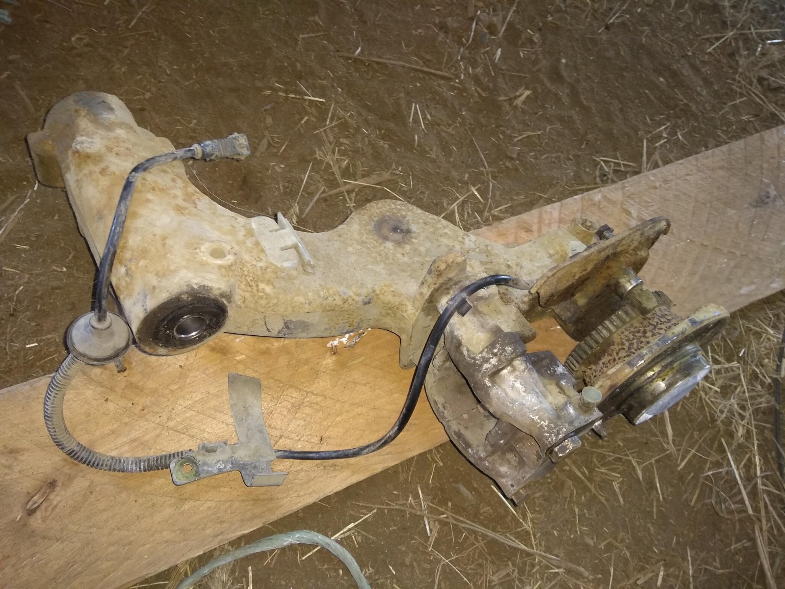

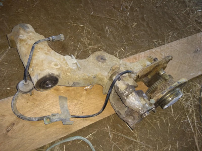

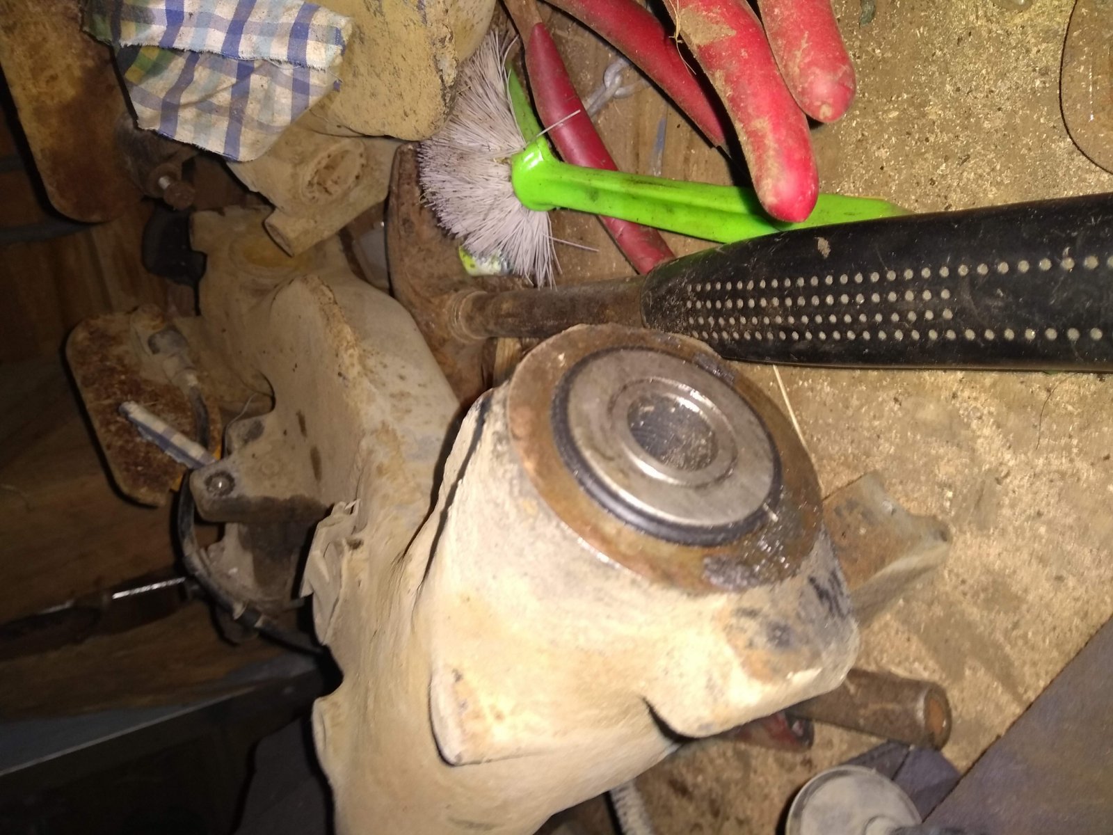

I have a tail-twitch in the handling of my Xantia during cornering which I now suspect is a swing-arm bearing. I also have a 'parts-car' and went through the removal procedure on that car as a test before I tackle my runner. This parts-car swing-arm bearings look good; is there any way to bench-test or identify visually? Also if these bearings are serviceable, any reason a non-hydractive swing arm could not be swapped into a hydractive car? Cheers

Do the rear wheels lean inwards at the top? The taper roller bearings are pre-loaded using shims, not by tightening the large bolt. The shims are available from Citroen. The clearance needs to measured between the bearing and the sub-frame and then the relevant shims inserted. This is done the the outer edge of the swing arm.
Over time the shims wear and the pre-load gets less.

Re: rear trailing arm bearings
Hi Pete
No appreciable lean in, maybe a tiny amount, nothing like my trusty BX TZD when its arm bearings went (still wish I had that one...
No indication of any shim material between the bearing and the sub-frame...
Cheers, Simon
