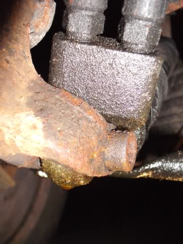

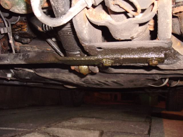

Managed to get something of a look the other day, and I'm quite surprised by what I found:
There is a drip on the end of the ram, but the underside of the cross-member is soaked! Also, the gaiter on the ram only appears to be damp from halfway down, like it's been sprayed from a particular angle (not sure if this is LHM or not though).
The bottom of the ram appears damp around the unions, but I believe this isn't unusual:
I managed to feel underneath the gaiter, and it wasn't particularly damp. Could this be coming from somewhere other than the ram?

I'd suggest your rear height corrector looks very wet or is the coating on
it lubrication to make it freely moving and purely preventative in nature?
Too much of a coincidence and the whole back end will cop stains from the
leaking LHM - been here, done that! Mind the price or replacement height
correctors is getting near the cost of an Activa ram these days!! :?

Looks like the same as on mine James.. Not the ram as such but the leakage return collar. You'd be amazed at how LHM travels in the turbulence under a car. It is almost precisely a duplicate of mine... More on the tie bar than anything else.
I'd say the source is the ram as if sphere blocks are leaking, the first sign is usually drips on the sphere itself..

CitroJim wrote:Looks like the same as on mine James.. Not the ram as such but the leakage return collar. You'd be amazed at how LHM travels in the turbulence under a car. It is almost precisely a duplicate of mine... More on the tie bar than anything else.
Yes, I suppose that would be where the airflow would send it. You'd think that with my aircraft facination, I'd have thought of that! I wonder if there's a dodgy batch of rear rams about?

Well possibly... That's my thought on it.
Mine was new in 2007... So I reckon ours are both of the same batch....
Give the ram a really good clean up and see where it first starts to look wet...

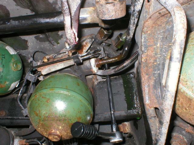

Despite warmer weather in the week, mine got worse and worse. Just leaking from the collar.
So today I swapped it for a spare I had. See my blog for the full story :twisted:
I'll be doing a pictorial guide soon. It is not an easy job at all. Fiddly :twisted:
Just to give a taster, here's the location of the ram supply pipe unions. These are located up high and almost on the boot floor... Getting them undone is fun :twisted:
