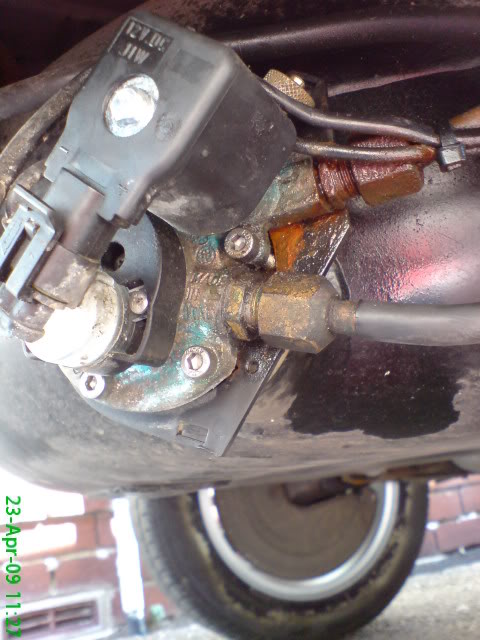

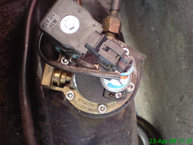

Here's a couple of shots of a Tomasetto mutivalve on my XM.
The Knurled 'disc' above the solenoid is the manual shutoff valve. The damp patch is penetrating oil.
Steve.
