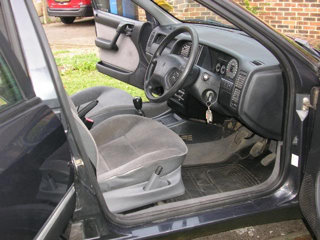

Hi Nigel
I may have misread some of this thread but i think you are saying that you have a n/s electric mirror and a o/s manual mirror :?
I have had a Xantia with manual mirrors (sorry Jim they do exist :) ) and the toggal for adjusting them is in the door card just where the button for adjusting the electric ones is :?
When i had my 1.9d n/a( that i managed to take swimming :oops: ) i had to change both mirrors(manual) and they were quite easy to replace once you get the door card/trim off its held in by a few torx screws.If you have a n/s electric mirror can you adjust it from the drivers seat ie with the switch ?? If so i reckon you have the incorrect mirror fitted on the drivers side
The correct manual mirror adjuster is just visible in the picture below,just below the interior door release.Although it is on the n/s door the location should be the same on the drivers side
If it is the case that you have an electrically adjustable n/s mirror with the adjusting button in the drivers door card i reckon someone in the past has swapped your o/s one for something from possably another model of car
Hope this helps and doesnt confuse the issue
