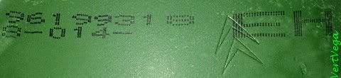

Here's a pic of double diaphragm "M" (Multicouche) from mine and I think they are more durable than single diaphragms.DickieG wrote:In very cold climates Citroën use sphere's of an alternative specification, believe the diaphragm is made of a different material or double skinned.Chris570 wrote:does the cold make the suspension harder? (my thinking is the nitrogen losing volume)
But even a M-type sphere is not forever... Last summer my Xantia made me learn more about these issues ...
LHM+ has very good cold characteristics (-20°C and below) and when the car gets warm then the suspension becomes
completely normal, no difference.
