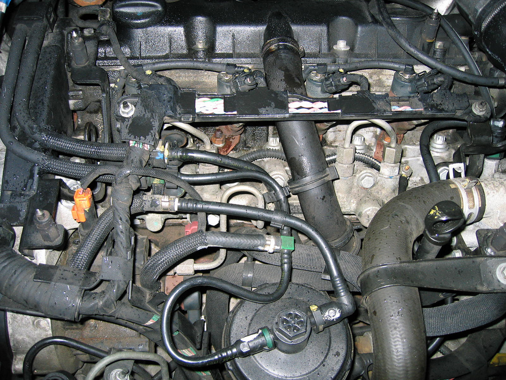

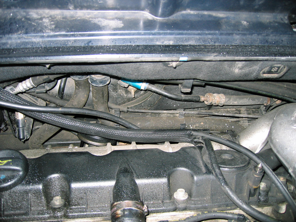

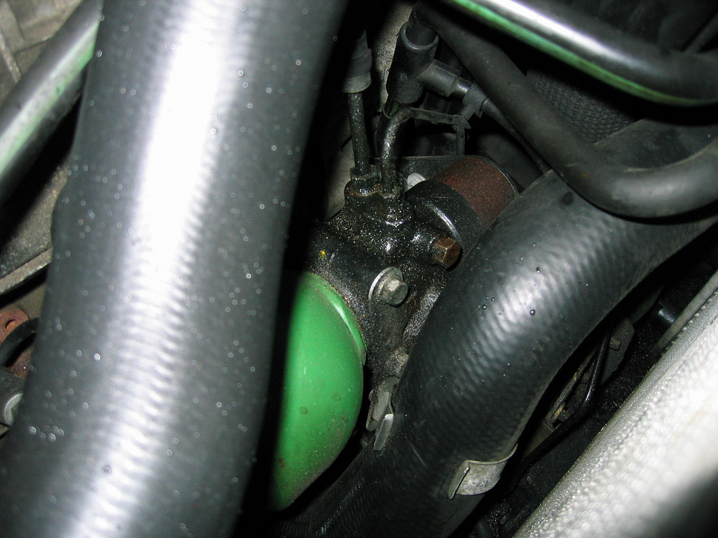

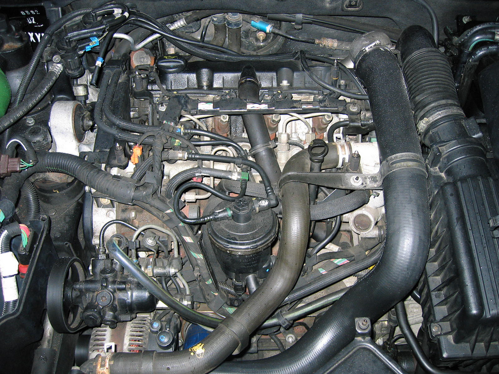

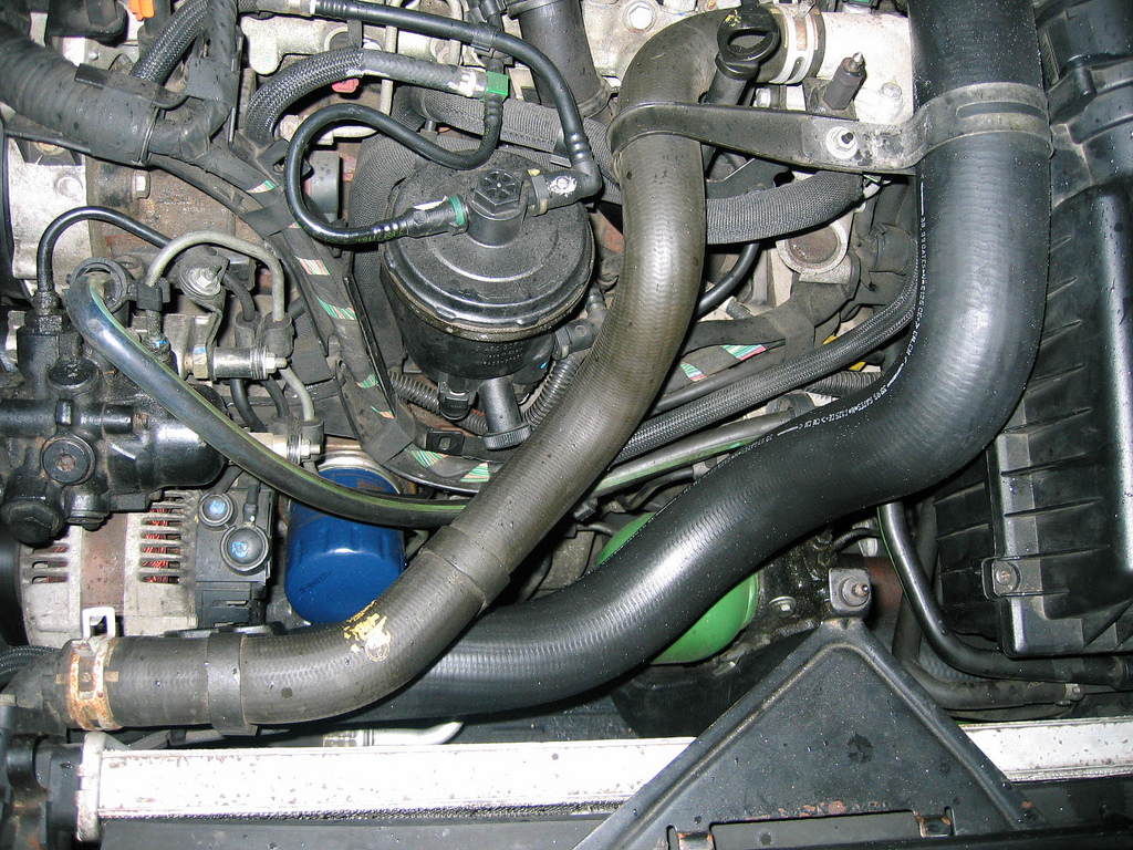

I've just taken a few in the pouring rain and got caught by the Mrs returning from shopping who shouted "Saddo" at me standing there in the pouring rain taking pictures whilst trying to hold an umberella
Bear in mind that I've cut and blocked off the EGR valve vacuum hose.
The rubber pipe and the two pipes contained in the braided sleeve are clipped to the rear of the engine cover.

Dude thats fantastic , just what I've been after
Shows me that I'm missing LOADS of pipe supports and brackets , the front engine cover and most significantly the pipe holders on the hydraulic pump !!! That complete bolt and all the spacers is just not there on mine !! Proves my suspicion that mine has had an engine change and the muppets that did it just left stuff off when they couldn't work out where it went !

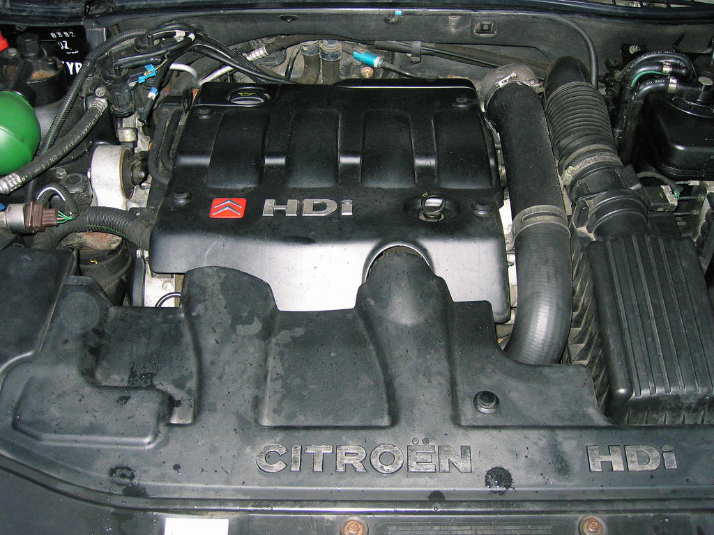

Make sure you have provision for the VERY FRONT cover, this cover didn't come along untill VERY LATE W 1999 reg plate till Y reg..
Another noted thing this, as I have a customer with a W reg 1999 HDi 110, and it DOES NOT have the front cover, nor the brackets, and the cover for the ECU's is intrigated into it aswell, and a friends W reg 1999 Xantia HAS got it.. another run out addition..

Well mines a T plate and as you mention it doesn't have that triangular bracket mounted by the radiator , I was assuming the muppets had left it off ? Also , the ECU has it's own cover.

Its only LATE W 2000 to 2001 Y models that had the front cover..
MADE A SMALL MISTYPE - NOT W 1999 model, but W 2000 MODEL YEAR.
However, if you can get the triangluar fixing point and the slightly modified battery tray and the cover, I cant see why it cant be retro fitted..
The excellent thing is that one of the intercooler pipes is out of the way as it goes UNDER the engine/gearbox rather then over the engine..
