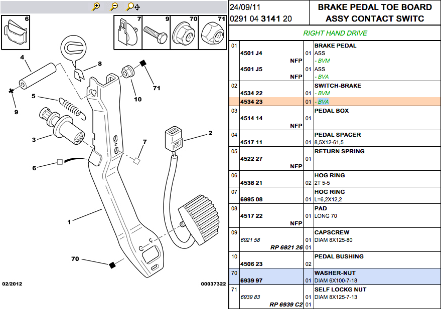

I have an intermittent problem, and have narrowed it down to the pedal switch. It's about to be removed and inspected.

Yep, had x2 pedal switches recently fail on different Xantia and I rarely keep my foot lingering on the pedal! lol
If the Xant is a manual gearbox car the availability isn't too bad - it's awful if you need a wide auto pedal switch
though as I found out recently on my V6!!
There's x1 10mm nut holding the switch onto the bar of the pedal and the wiring from it runs up to a
single multi plug up near the steering column.
ebay 350612254274

Had been searching for 8 months with absolutely no joy after pursuing every lead I could and in the
end got really fed up with people replying that the wheelnut they were auctioning on ebay had been
weighed in and the pedal wasn't saved. In the end I ended up scrapping a Xantia that coincidentally
had an autobox. It's the same on an Xm so there's a whole load of them sold compared with Xantiae
so that's your best bet. The pedal switch on the auto one is completely different to the manual type
so no chance of swapping the innards around. Of course it's an MOT fail so I needed to borrow a
switch off another daily runner auto to pass the test...

Hello everybody, I am suffering at the hands...or feet of my brake pedal switch too. checked fuses and bulbs all fine so i looked at taking the pedal apart and switch out. The copper piece inside the unit where the spring has pressure on it has snapped and i cant fix it. PLEASE somebody tell me where i buy a new whole pedal brake switch?! Thanks

Is this it?
http://www.ebay.co.uk/itm/CITROEN-XANTI ... SwNE5YW6j1
There are others on there, just depends on your original car parts number I suppose.
