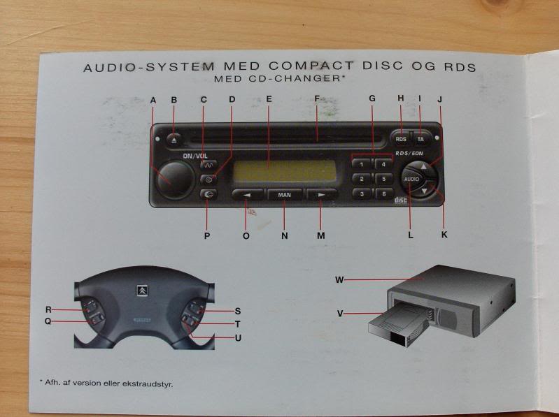

That CD player in the handbook's not a Blaupunkt. It's a Clarion PU-2294B. :-k
Found in the Saxo, Berlingo and Xsara...

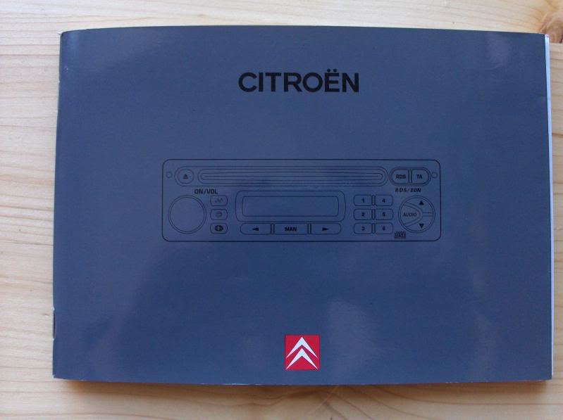

He he he he. ](*,) I take your word for it.... I don't know how I got into my head that it was a blaupunkt......I have gone through the Manual and it says NOTHING about the make of the unit at all..

Believe me, it's a Clarion. :)
So now that we've established that, next job is to check that remote control cable. I'm 99.99% sure it's going to be plugged into the "real" remote connector behind the dash somewhere.
Get digging. And get some photos of what you find. [-o<
