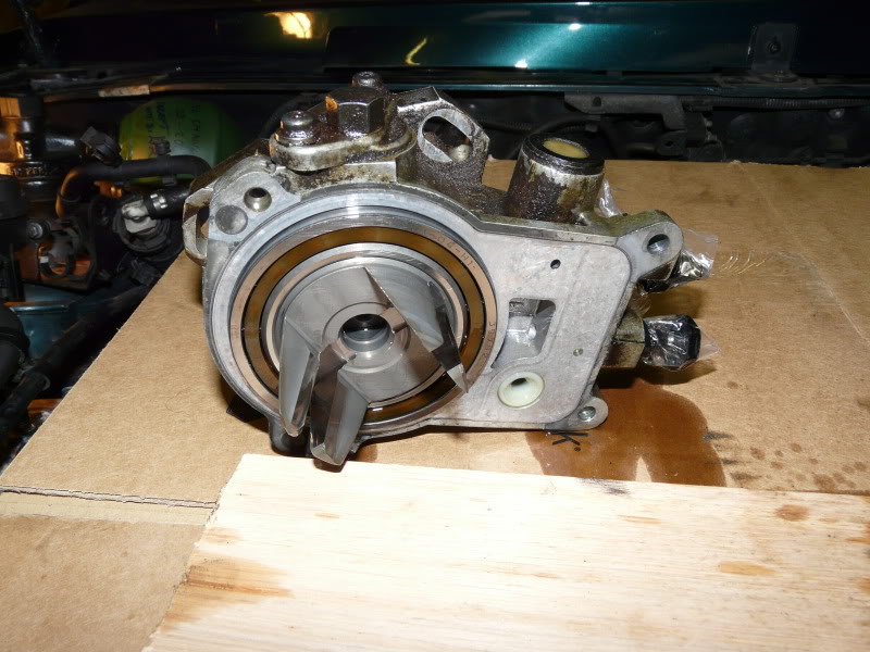

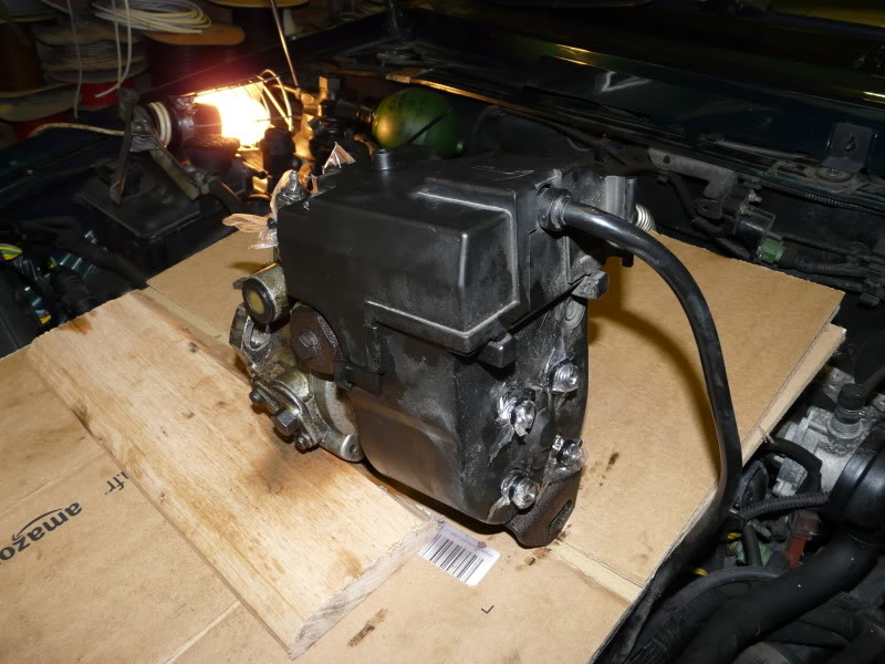

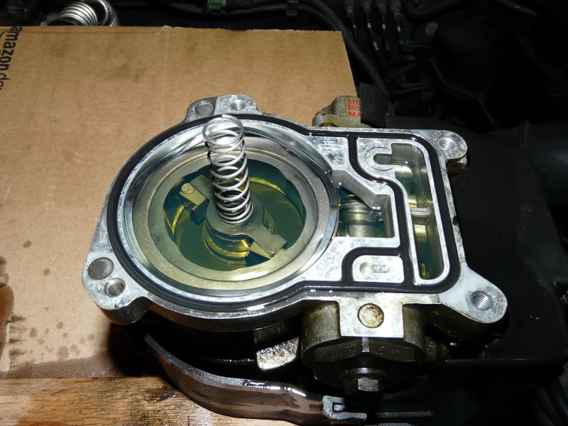

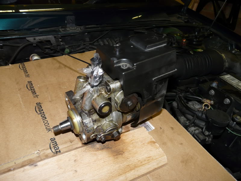

Finally got round to getting my seal kit and worked up the courage to tackle my leaking pump. It was leaking from the centre join, and after studying the various drawings and texts you were all kind enough to provide me with I decided that I could whip out the pump and pop a new seal seal in and save my self £600+. It went quite smoothly and my guess was correct the pump did split into two as expected, popped new seal in (had to re-align the two pump veins as they moved slightly) and bolted all back up again and refitted on to motor. Bleed fuel through and cranked her and it fired about the third go. Ticked over nicely, stopped and started again fine. Decided to let it warm up a bit, and as it did the revs dropped back slightly and it just started hunting a bit. Am I correct in thinking that the timing is probably just a fraction out? I did mark the pump first before removing it but only with marker pen (5 times) but the lines got a bit blurred with the diesel and handling so it could be a fraction out. Had enough for today so gonna slacken bolts off tomorrow and see how it runs after moving a fraction. Couple of piccys of pump out and inside of it

Well done hobblerian
Very good work indeed! I pay you my greatest respects. I can't wait to open one up myself!
With regard to the static timing, there is a procedure that must be carried out whenever the pup is removed/replaced. It involves the hexagonal plug on the side of the pump. I have the procedure documented at home and as soon as I,m there, I'll dig it out for you.
Did you expose the ESOS valves during the strip?
