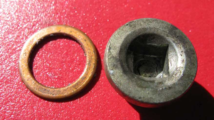

asav, The 'small squair hole' is infact the top of a bolt, the bolt is in the filler hole. The PDF says 'remove fillter plug', that is the filler plug, you need square drain plug key tool to remove. Here is an image of what one looks like.
Here is a picture of the bolt when removed, also shown the crush washer.

ohhh, shall try an get a drain plug key...

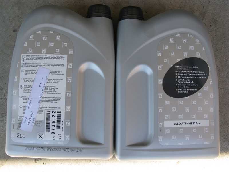

Asav, I assume by ‘citro specialist’ you mean Citroen parts dept at the official Citroen dealer, The price is right, but to be sure does the bottle look like this?

brilliant...thanks again..very much, I now know what i'm doing :?, its little things like putting it into 2nd that you really need to know, cos i was thinking i'm gonna have a really hard time getting to that cap.
Yeap thats the bottle!
