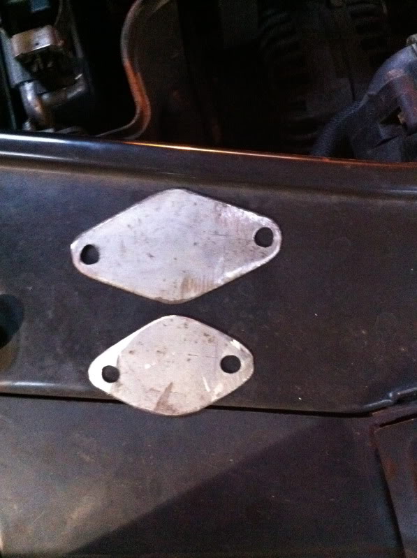

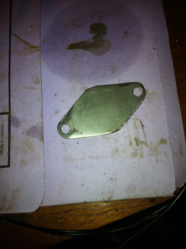

Well I spent this afternoon messing around with the Xantia.
I fabricated 2 metal plates and used them to blank off both ends of the EGR valve.
Is leaving these plates in place going to cause any long term problems with the car?
Once fitted I started the car and took it for a run, unfortunately it was dark so I didn't get a chance to properly monitor the smoke until I got home.
I'm used to driving a 406 HDi 90 and by comparison this 110 Xantia feels like it's flying. I also started our SX and listened to them running side by side to compare. I wouldn't say one of them sounds noisier then the other.
The car that smokes does have a bit of injector rattle, my 306 did this also but it didn't smoke at all. I believe this is common on the HDi's though.
Another thing I noticed today was if I took the oil filler cap off with the engine running there was a puff of smoke that came out of that. It sounded almost like it was breathing through the oil filler.
I'm just about to go and stick it on the Lexia to see what the boost pressure is running at too.
David.
