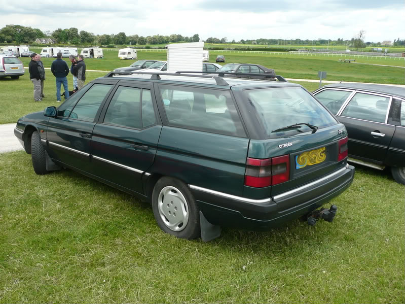

This is my Xm, you see the front tyre Vs are going the right way:

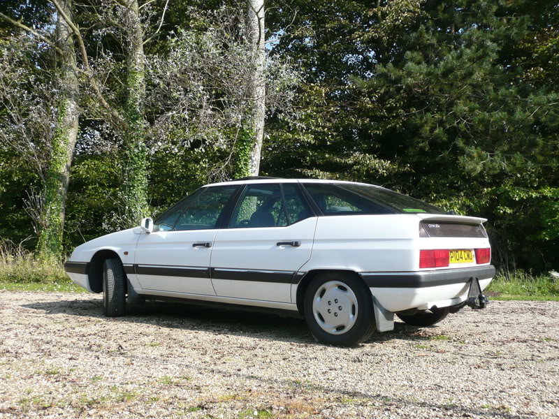

This Xm (sorry if this is someones on here) has V tyres but the front one is going the wrong way, so its fitted to the rim as if it should be on the o/s side, not the n/s:
But swap that over to the other side and it will be fine, or get it swapped around on the rim and it would also be fine. As it was its going in the wrong direction, so it will be collecting water instead of dispersing it away like it should.
Proves you cant swap a directional tyre from side to side without having it turned around on the rim first, in which case it would be running the same way again.
