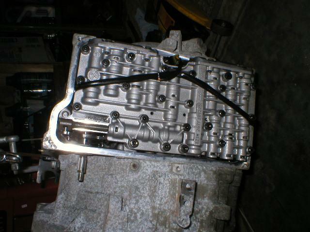

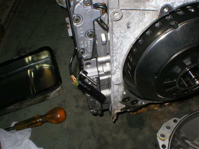

I slipped off the valve block cover next

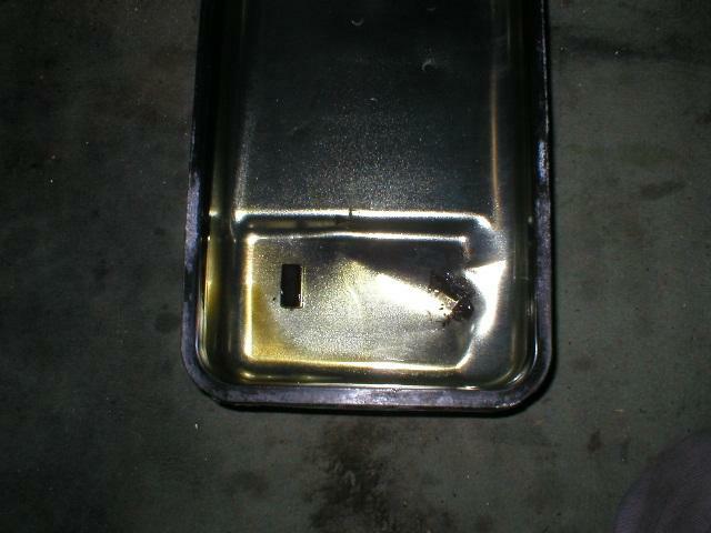

And inside the cover I found some magnets to collect swarf. The cover had been dented in the accident this donor vehicle sustained and one of the magnets was broken. Bits were stuck to the valve block.

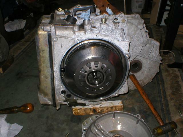

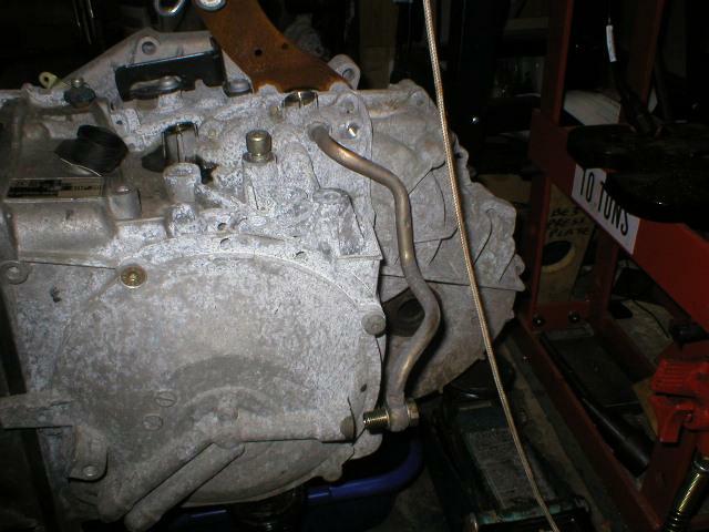

Next to come off was the rear circular cover but first the oil pipe needed to be removed.

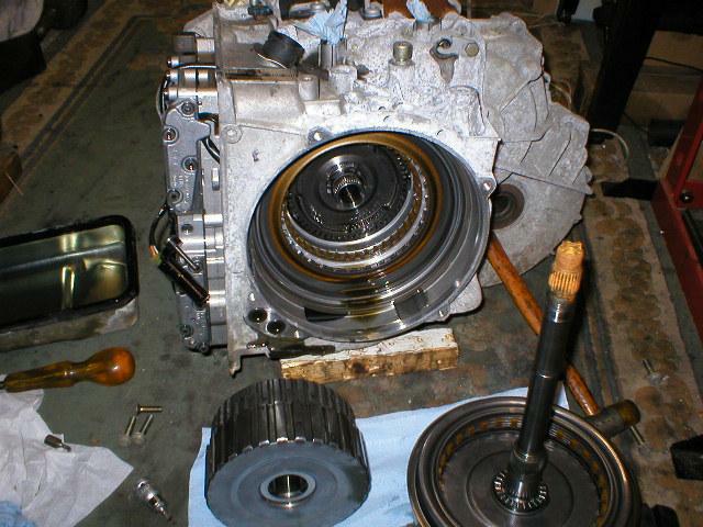

Then the cover to expose the front clutch drum.

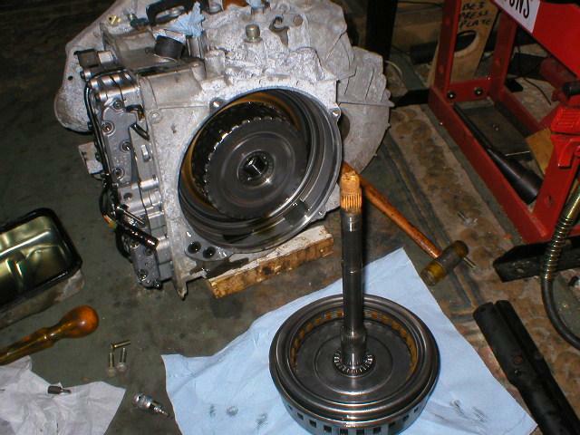

I thn found the front clutch drum would move forward but was stopped by the input speed sensor. The sensor was removed.
Then the whole front clutch and input shaft could be withdrawn!
Along with the first epicyclic gearset..

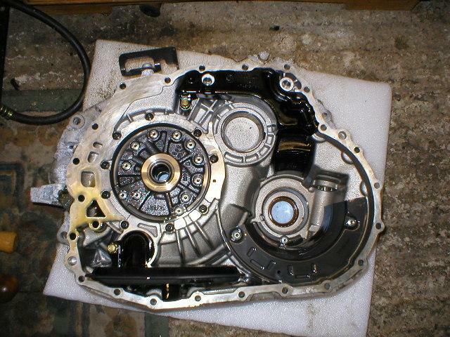

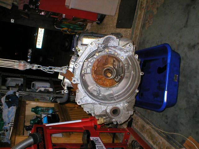

The 'box could now be tipped on its back, resting on a slab of foam and the bolts holding the two halves together removed. The two halves could then be carefully separated, leaving this...
This view shows the oil pump and filter in the bellhousing half of the case.

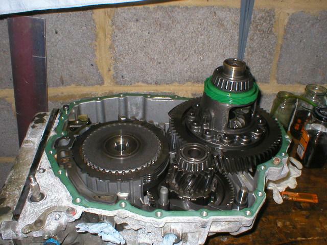

Here is the other half containing the diff and second epicyclic gearset..

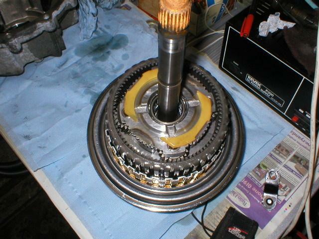

And finally, here is a picture of the front clutch and epicyclic gearset up close...
