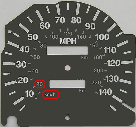

Hell Razor5543 wrote:... Swapped it out, switched on the ignition, and the ABS light was STILL on!,,,
100 yards later the light went out! :-D It would seem that the ABS ECU has to see the sensor and then know that it works before it is ready to accept it....
Nice to read your good news :)
Speaking from my experience (several experiments :wink: ),
actually it is not the distance but the speed.
With the new sensor static sensor reading might be fine
but it must also give healthy result when the the car goes
over the threshold speed. This critical speed is 20 km/h.
I guess the equivalent value can be seen in below pic:
