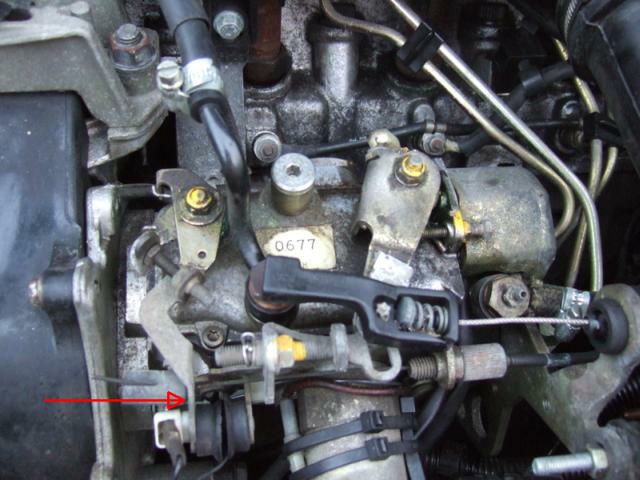

Neil, try putting your foot down a little way on the throttle whilst trying a start and see if it starts a little better. Not too far though, say, about an eighth... If it does, then your waxstat is not healthy. It'll not be pulling the fast idle lever to the fast position and not engaging cold advance. Another test you can do is to try forcing the pump into cold start mode by operating the lever manually to the right (as you look at it with the bonnet up) and temporarily securing it there.
The lever is shown in the picture below by the arrow. Push it in the direction of the arrow for cold start mode.
Just below the arrow is the switch contact for the cold start advance solenoid.
