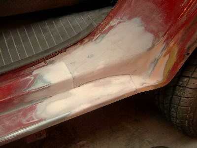

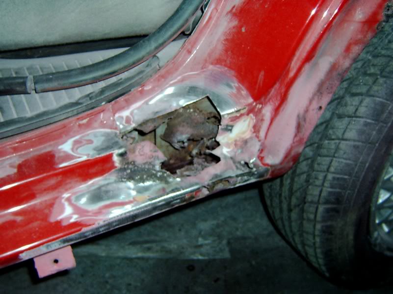

This seam is not a million miles away from the C pillar join on my Maestro. From factory it should have a thin smear of seam sealer, on my Maestro, all external seams like this had nothing to stop the water getting in.
Because its spot welded the seam will not be perfectly flat, and a build up of moisture and dirt will form, especially if you are not keen on washing the door shut out.
Here a bodged Maestro one, it had been plastered with filler over the years making it worse. The Maestro in question was well known and i had to do lots of welding for the chap to make it good.
My advice would be to keep it clean, and apply a coat of waxoyl over the seam if you want a quick and easy way of holdling it back. Next step would be to clean all the paint off the area and use a rust killer, zinc/anti rust primer and a coat of seam sealer, then your usual paint finishing. Inside treat the box section with Waxoyl or similar.

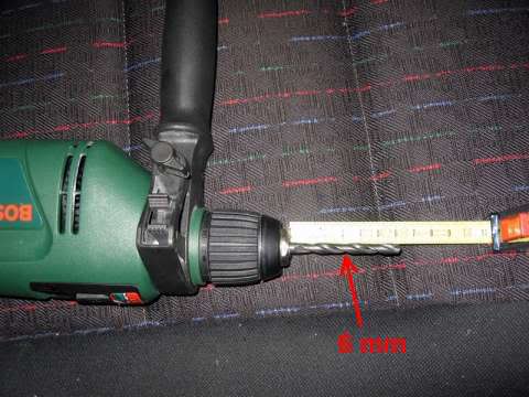

Hi guys, The drilling project has been completed successfully. Thanks to marsalek for the pictures and seat belt hint :D (marsalek, Please give my regards to "jk". His photos very very helpful.)

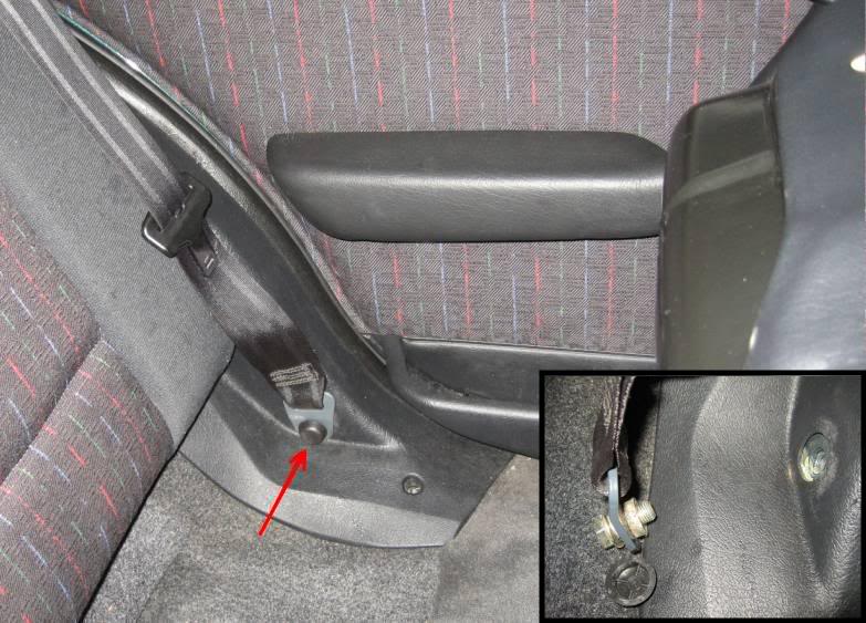

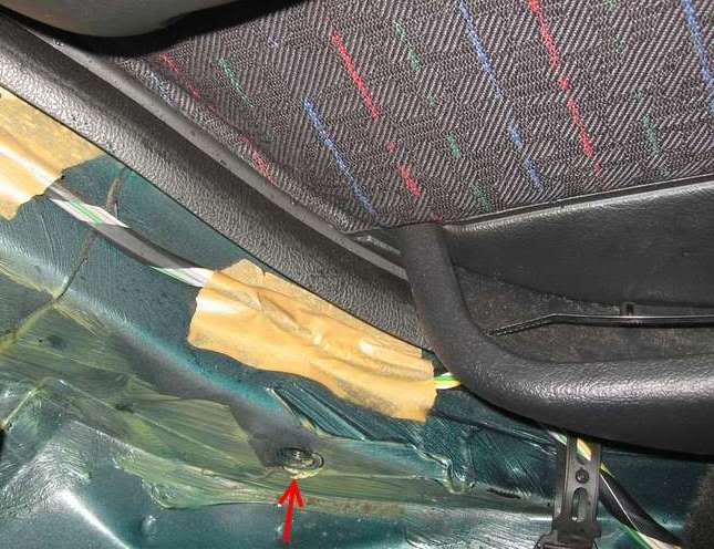

It is a rather straight forward process and quite easy. First lift the rear seat to reach the lower bolt of the seat belt. Removing it would give you better working space.
I had seat belt rolling back problem. So I decided to remove the plastic covering. Belt was folded as seen in the photo. Now the seat belt problem is also solved :D

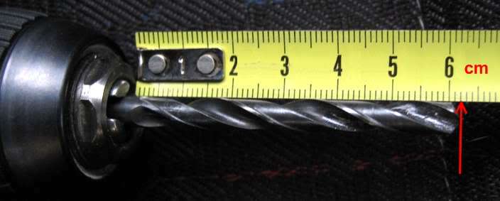

Using a 6 mm drill head I made a hole through the first sheet and then the second sheet. Attn. second sheet is very thin.
This depth was still safe. No undesired holes.
I applied penetrating oil. It came between the sheet joints. For the next times I just have to remove the lower seat belt bolt and there we go. :D

It had a short straw (~7.5 cm) which I have replaced with a longer one (~11cm).
Check marsalek's message on page 1 (PostPosted: Thu Nov 06, 2008 9:31 am ). In the last photo there is a red circle drawn. That's where the drill tip reaches, the cavity.
Through that hole you can apply spray to the upper surface of the sheet. Under part can be handled from the rectangular rubber plug (rear tyre area).

Thanks for your nice photo story! I have forgotten another hint. You can also spray into the hole for the bolts holding the counterpart of the rear door lock. That place is by far not as good as the seat belt bolt, but you might reach better the most outside part of the cavity.
