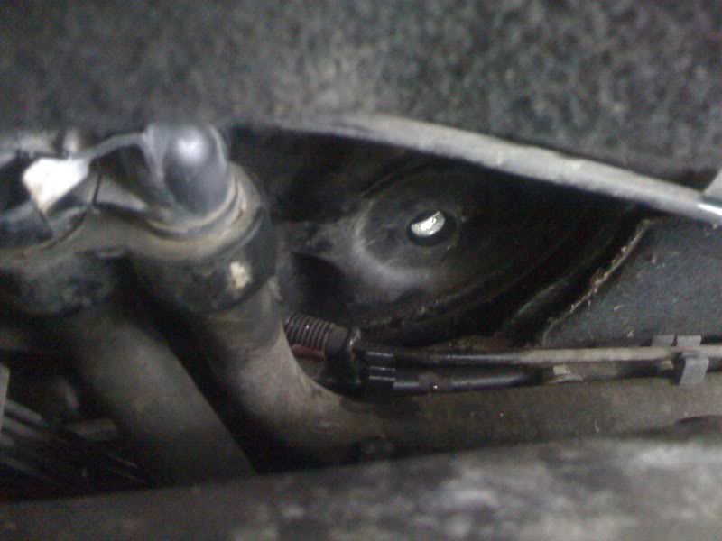

Thanks Jim, hopefully these pics will up load, if not i may need some assistance, anyway the 1st pic shows the blower motor, the part that is not working sits in the triangular section of the casing, the (previous ) owner has the part somewhere and will have it when i collect the car.
The second pic, shows the plastic hose junction to the heater, the left section has been snapped off when removing the hose, i assume that the 2 junctions are flow/return , just off camera at the bottom of pic are the hoses joined with section of copper pipe, sorry if the 2nd pic is too close-up, but any further away and you can't see it at all !
cheers Paul......

Relatively speaking, you're in luck with the bulkhead fitting with the two
pipes.
This is the heater matrix inlet/outlet and is the same on all Xantiae.
If you get the first rigid plastic mounting piece with the integral spring
detached off a scrappy car and keep/cut the first 3-4" of hosing below it,
there's a good chance you can joint it all together and reconstitute your
bespoke V6 pipes with a section of plastic pipe.
Just visible in the middle (to the right of the bleed screw tyre valve cap)
the broken looking spring can usually be a bit of a sod to undo. This
damage looks isolated to the rigid plastic end of the hose that plugs
into the bulkhead. Beware though it's not unknown for the receiving
collar/end to break and this is the attachment onto the heater matrix
and a dash out job to replace. Have a VERY close looksee at what is
left there!
It won't be made any easier by the fat aircon pipe running tight over the
top of the fitting just to make life more 'challenging'...
He may very well have got shot of the car as there isn't ANY heat into the
cabin so it'll be Brass Monkeys for the coming Winter months.
The downside with the blower fan is you need the harder to get aircon
version - not any old version will do!
Andrew

I have a similarly blurry pic of the same pipe connector on a Xantia I
scrapped recently - I didn't keep any of these pipes as the rubber was
being eaten away by oil allowed to leak into the cooling circuit;
The spring is seen in the middle of the two rounded feed pipes. Annoyed
with myself now as a small length offcut on this would've helped you
- check out the local scrappy
Andrew
