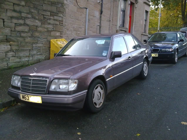

Well I've solved all my problems, I've just bought this for 300quid at auction:
MOTed till next September too! :D although it is a p-e-t-r-o-l! :shock:
I now need to decide how much to do to the 406 before I offload it. I will advertise it honestly as I know exactly what it feels like to be the mug.
