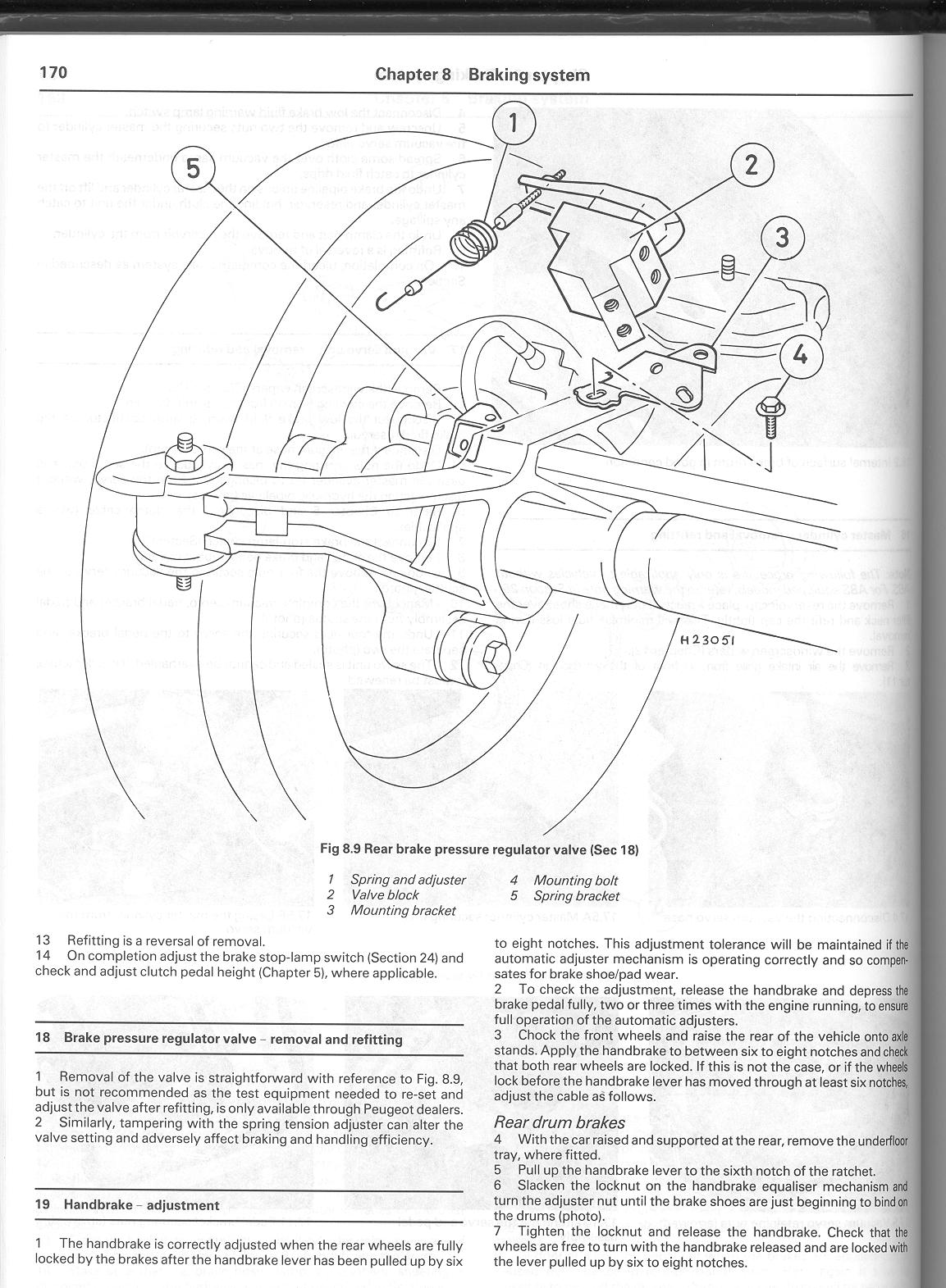

Sorry to hear about the MOT :cry: The tester was clearly in a bad mood or had a real downer on 405s :o Shocked the nearly new shocks and bushes failed so soon.
I found this in the old purple 405 BoL...
405 Brake Valve Location picture
Is this any help? It may not be fully applicable as it only covers the very early models...

thanks jim that was perfect!
i had to buy the whole compensater just to get the spring which was a bummer i refused point blank to buy new shocks so took the ones of the donor car and gave off to the guy at gsf. but i dont think i will get anywhere.
