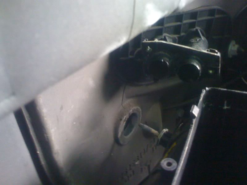

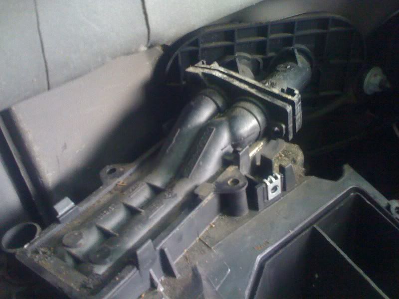

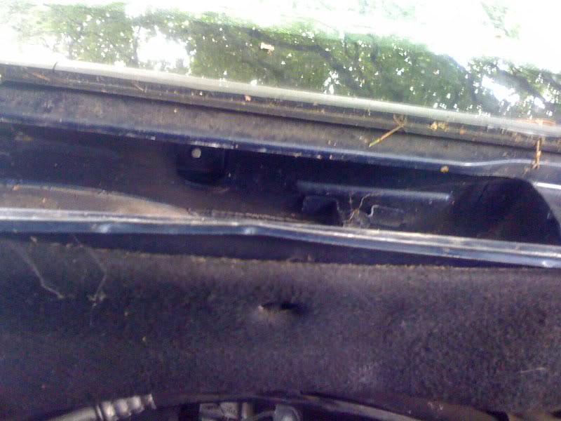

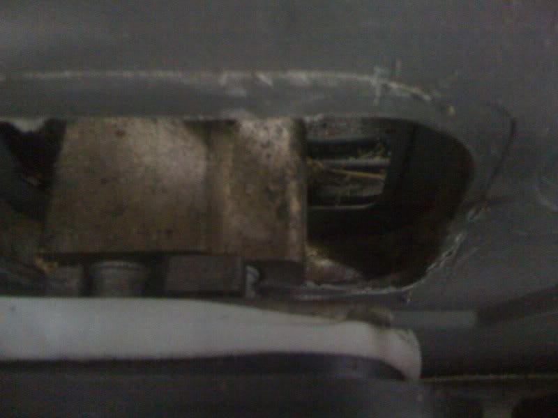

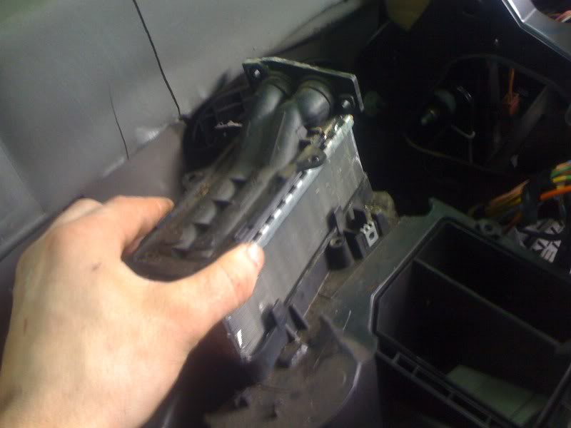

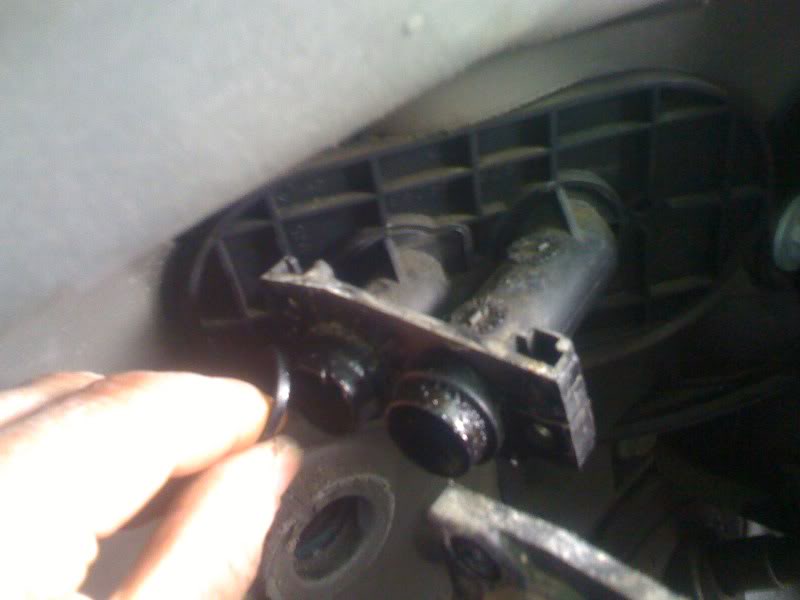

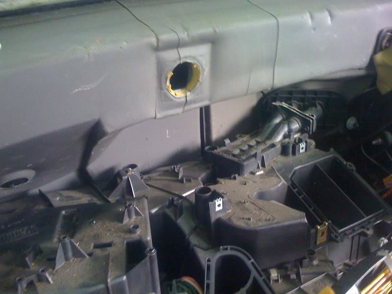

Some pictures showing the heater box removal on the scrapper:
where it hides behind the dash and wiring loom:
matrix collar bolts undone - lugs showing grip on the top of the matrix:
O rings:
grubby picture showing stud that goes through bulkhead securing the heater box:
one of the dash securing points high on the scuttle with daylight circle hole through bulkhead:
heater box fastener from engine bay side:
another grubby picture showing AC mounting drawn through into interior of the footwell:
the damned matrix! This one looked a bit wet inside the heater box and had traces of staining:
The undo of the AC drain tap was doable but all done by braille from above
as I couldn't reach anything from below. I'd hate to try and patch it all back
together again...
Andrew

- Posts: 55061
- x 8385
They're some seriously valuable pictures Andrew
You've answered a question perhaps in that it is possible to disconnect the matrix at the joint on the matrix rather than the much more difficult and risky water connector in the engine bay.
How easy was it to do it that way compared to the traditional method?
andmcit
- Posts: 4299
- Joined: 03 Mar 2005, 17:59
- x 30
Hi Jim.
The joint inside the car onto the matrix bulkhead comes apart easily
enough although it obviously needs the main heater box to have
slack movement, permitted by drawing it off the bulkhead.
I really needn't have undone the outside (engine bay) side at all as
the fitting doesn't need any movement and was only later tried where
I tested a new approach to undoing the outer fitting using a claw head
hammer head which worked a treat allowing a decent leverage but
still permittting space to get a hand onto the spring and main pipework
of the fitting.
I did try running the engine up to temperature first as you suggested.
Andrew

andmcit
- Posts: 4299
- x 30
There's no real strain or distortion on the joint and it's stepped with quite a
significant overlap and ultimately has the o rings to seal the joint so I can't
see how it could fail on it's own without a bit of additional help (provocation!).
The heater box undoes from the bulkhead and you can slide it sideways to
the left and back away from the joint and create enough clearance to allow
the matrix to lift upwards and out past the overhang of the main bulkhead.
I can't see a matrix going here very easily and have seen load fail on the
band strapping that runs around the end caps holding them onto the main
vanes of the matrix itself.
Andrew
