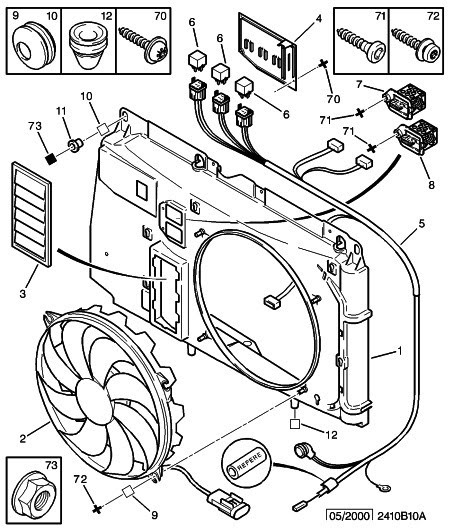

The coils are # 7 & 8 in this diagram:
What I don't understand is why the fan would run at all during normal driving
....surely radiators these days can cope with cooling the water from the engine without needing the fan to run at a low speed.

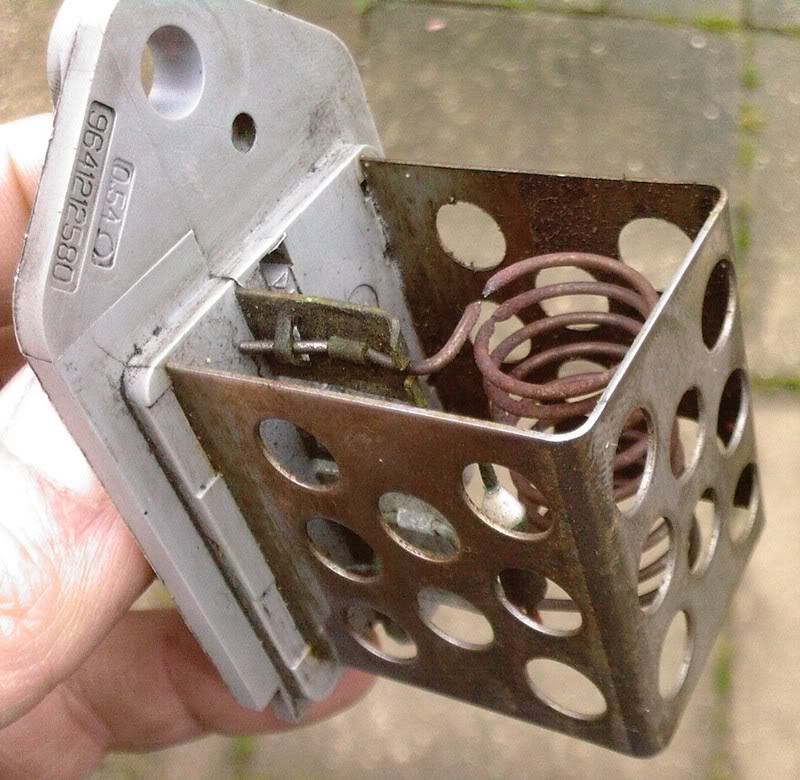

nick,
No the aircon wasn't on.
Ok have just been out & removed the coils & guess what one of them is broken.
The other coil is fine with the element being nice & clean just like new.
So it looks like I have the exact same problem that johninderbyshire suffered, thanks for your help john & putting me on the right track
I'll get a coil ordered from Citroen this morning as I doubt they will have one in stock & will let you all know how it goes.
Thanks once again for all the great help & advice offered.
