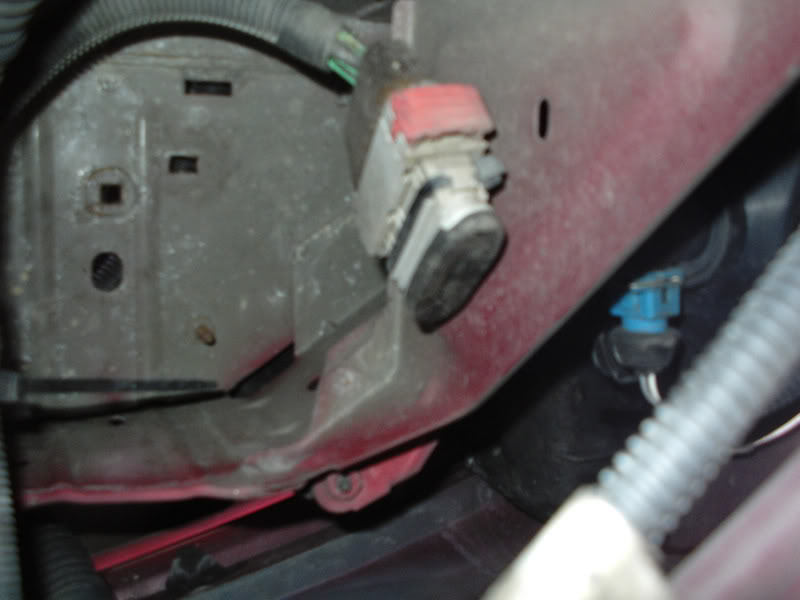

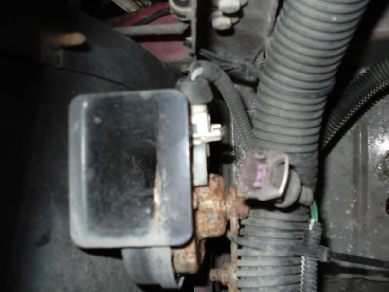

I'm getting cold feet about changing the head gasket now. I've been crawling under the engine trying to find hidden access for the planned work and made some discoveries. First up is this loose bolt which I cannot see what it's purpose is, though I suspect it's related to the recent clutch change? Sorry about the poor focus, it's the bolt in the middle of the picture. It feels as if there's a nut on the other end or something holding it in place, otherwise it's loose and I'm unable to tighten it. Can anyone identify it please?
Then I checked under the n/s wheelarch as a protected cable was drooping too low and I saw this spare connector sitting next to a single rusty looking horn. My Mk1 had two horns together, is this a horn connector or something else?
Foward from the spare connector I saw this unit which I can't identify. Is this the bitron unit I've been looking for, it looks different to the MK1 unit and is in a different place? Again, apologies for the poor focus.
Finally, you may have noticed it's rather wet and oily under there so I had a further nose around and think I've located it as coming from the turbo. It certainly looks like it's dripping off the short rubber coupling hose shown here.
All comments and advisories welcome.

Once again I'm answering my own questions
The loose bolt appears to be attached to nothing else so I'm thinking maybe there should be an engine tray there? I think Mr. Clutch did a very unprofessional job leaving bits off or loose and the gearbox might even be leaking, it's wet everywhere so hard to tell.
The oil leak still has me baffled as it's not easy to see behind the engine. I've found it's just as wet above the turbo covering the air inlet pipes and so began to suspect the fuel return pipe which is nearby. However, there's also wetness or staining pretty much all along the vicinity or the head/block joint so it could be part of the failed head gasket problem - if it is the gasket and not the head.

Hi Mike
im only guessing here but for what its worth........
1st picture if bolt is 10mm my guess is same as yours engine tray probably got one of those funny clip type bolts(like in the dash holding bits of facia together you know what i mean
) probably thats what keeps turning
2nd picture that looks the same setup as my n/a Xantia horn setup 2 plugs 1 for each horn
3rd picture i reckon could well be for headlight washer/wiper or something similar dont think its bitron but hey ive been wrong before
4th picture pass over to someone with some real knowledge
colin
ps as an afterthought Mike maybe a good engine clean/degrease may help you see where/what is leaking some of that stuff could have been there months
colin

Hopefully the bolt is nothing to worry about, there's one on the driver's side that is tightened up to a rubber grommet or plastic spacer but I didn't spend too long checking it out. Do I take it the Mk2 has twin horns then? I recall the Mk1 had twin horns but three connectors in that area
If that isn't the bitron then I've yet to find it. Must be under the headlamp. As for cleaning the oil leaks - hosing it from underneath will not be a pleasant experience, I'm sure.
Wiping would be a mammoth task.
