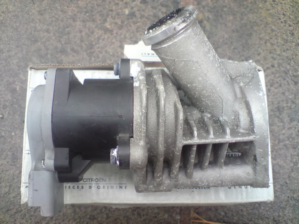

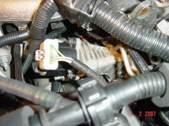

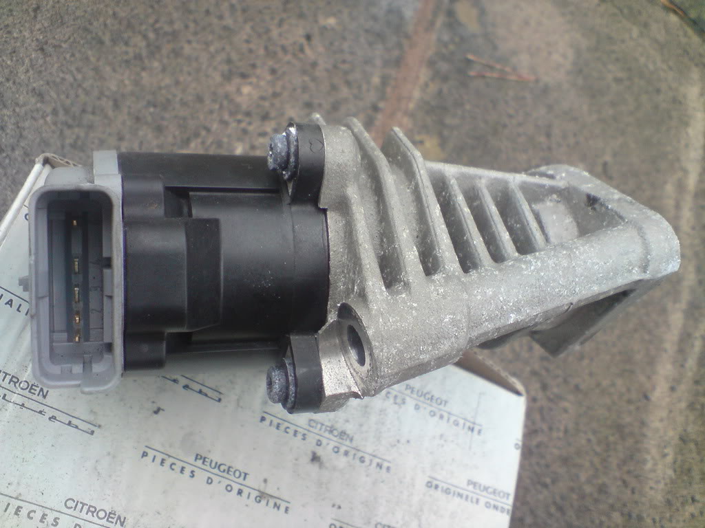

I had the EGR valve replaced last year. The top multiplug arrowed in your picture is it, I have a better picture somewhere....
Here you go
It's dead easy to replace, 2 bolts (where that fluited casting meets the engine), but it costs about £140
Here you go

I will make an educated guess that it'll be on the exhaust manifold somewhere and there'll be a pipe leading from it to the inlet manifold somewhere. If you can take a whole engine picture and a picture of the exhaust manifold if possible, we should be able to identify it.
It is not the cylindrical item you have arrowed in the picture, that looks like the Idle Control Valve and I don't reckon it's the other device pictured.

Pete, I have the old one in the garage somewhere. If you can hang on 'till tomorrow afternoon I'll take some better pics of it so that you can see it off the car. I'm just thinking about the codes you're getting and my memories of what the device looks like and wondering whether it's actually a valve, or some kind of sensor or actuator (maybe an actuator operating a valve internal to the engine
P0400 Exhaust Gas Recirculation Flow
P0403 Exhaust Gas Recirculation Control Circuit
Looking at the codes I'm thinking this is maybe the "control circuit" that isn't working resulting in the lack of "flow".

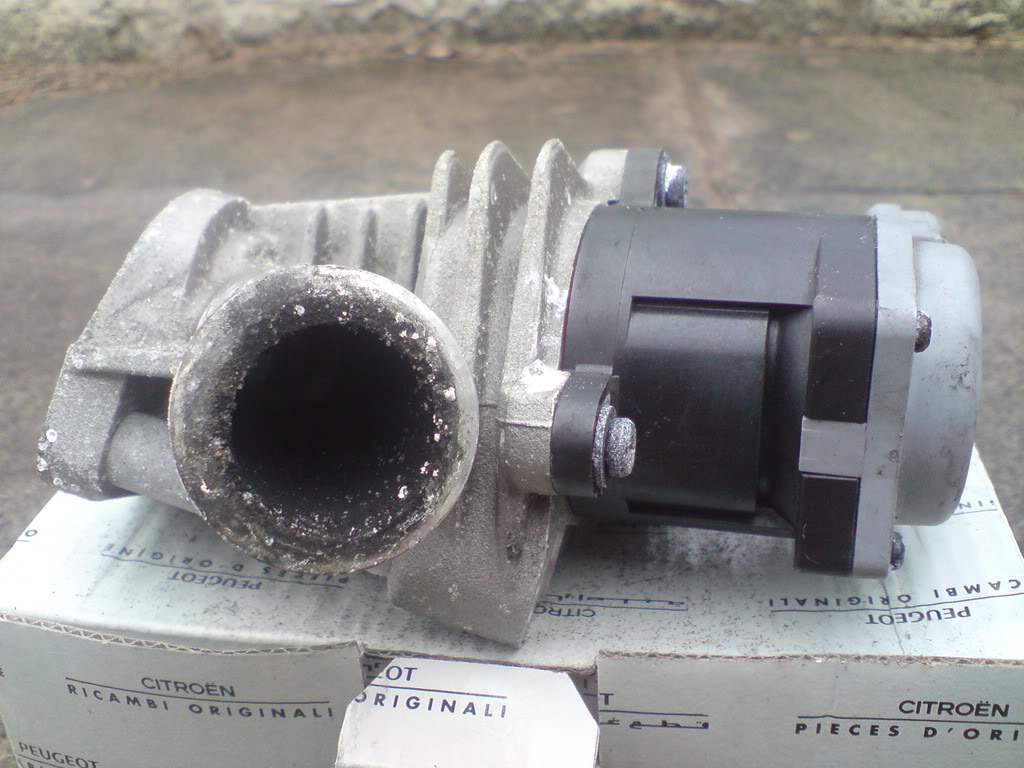

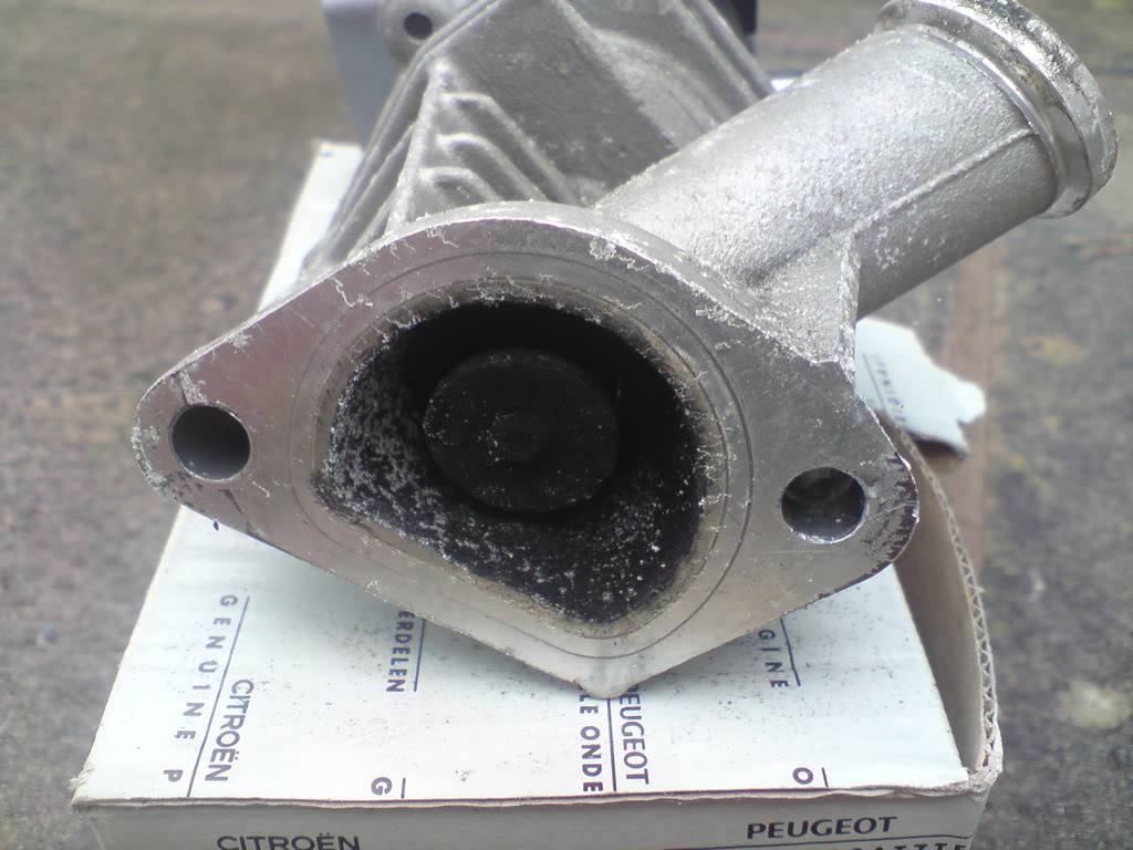

Fantastic pictures Dai
It looks like a poppet type EGR valve. A motor will drive the valve up and down to open and close it and a pot (variable resistor- like a volume control) will relay back to the ECU whereabouts in its travel it is.
If it sticks, the ECU will not be able to set it to where it desires it to be and thus detects and logs an EGR error.
As it's not hard to remove, a clean is worth a go and looking at the pictures, It woukd not be hard to block one of the orifices off for test purposes. You could almost push a rubber bung tightly in the angled outlet pipe to block it and the ECU would be none the wiser.
