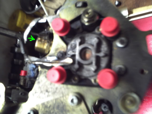

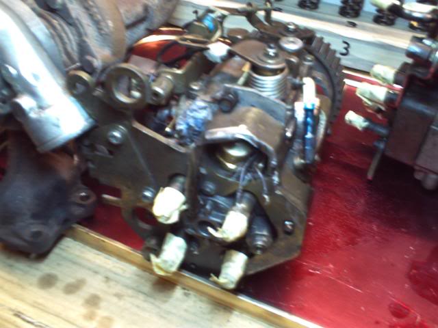

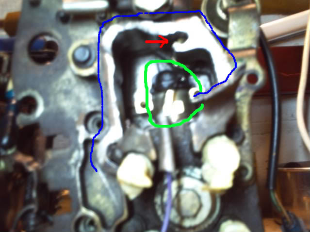

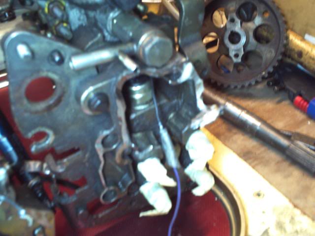

Hi , I got these pumps in and thought it be good to show how some people remove or cut them open ,, sometimes it can be done neatly with out removing the pump , very careful on the Bosch pumps= just above were the shut off solenoid is , there is the fuelling adjuster screw ( arrowed in pic ) which is surrounded by the immobiliser shielding if you hit the shielding with hammer and chisel you may damage the top of the pump ,, there'll be a circuit board that needs to be pulled out so you can access the shut-off solenoid ,, to do this job correctly I'd remove the pump and withdraw the anti tamper snap head bolts .
Using the older D Turbo pumps will make the later cars go better because to keep with emissions over the years the fuelling screw has been backed off ,
my last 306 DW8 you had to plan in your diary if you wanted to overtake another vehicle , so I wound the fuelling screw in ( removed the shielding first ) a good bit keeping within emissions , it would then keep up with a 205d Turbo , I did this when the car had 32k miles on and gave the car to the father inlaw at 84k miles only missing a beat when the shut-off valve failed
