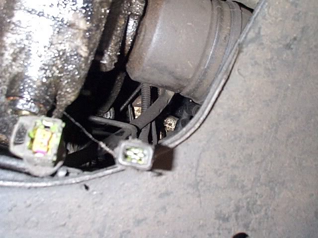

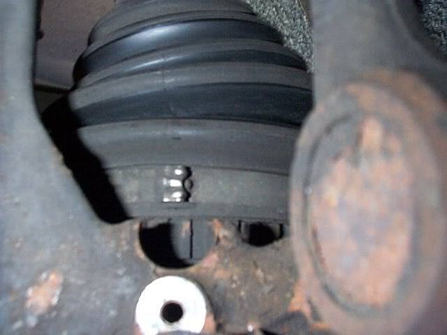

Well, here a photo diary of how to take off the Passenger side ABS sensor
First i put the car onto some ramps, and chocked the back wheels, once i was satisfied that the car wasn't going to go any where in a hurry, i shimmed my way under the car.
Following the cable from the sensor, i located the Block connector that the cable was plugged into and proceed to unclip it from its mounts from the connector block to the sensor.
There was a bit of a fiddly bit, because a set of stiff pipes blocked the connector block, from coming out, so had to use a long screw driver to lever it out the way a bit.
Now that the cable was free, i tide it up to the very last clipping place, inside the wheel arch to make sure it was out of the way of the wheel and any other moving parts.

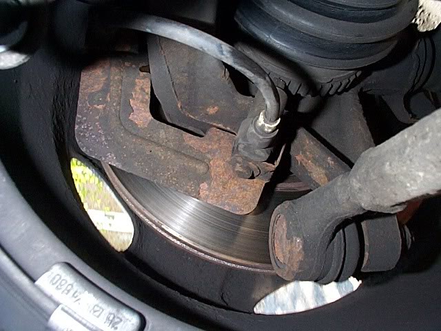

Taking it back off of the ramps, and moving them out of the way, loosen the wheel nuts off just so they are slack, then jack the car and support it with axle stands, i don't have axle stand, to had to put my wheel under the car, just in case the jack failed. (better to have a damaged wheel and still be able to jack the car up, then not be able to get a jack under and need lifting equipment) and chock the drivers side front and back wheels.
Now that the car is in the air, undo the nuts, the rest of the way and take the wheel off.

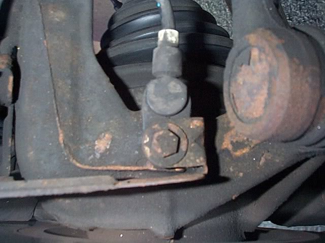

Now, the ABS sensor is located, behind the brake disk on the right hand side, when looking at it face on.
There is one 10mm bolt, holding the sensor to the wheel strut
(please note, on some models it might be a 10mm retaining nut, then a 10mm bold mounted on the thread behind it, so pay attention)
Once the bolt is removed, try wiggling the sensor, if it fails to move, lightly tap it, till it starts to free up, once its free pull it clear of its mount, and unclip the rest of the cable. you should now have a removed ABS sensor, without damage.

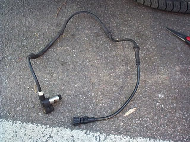

The full sensor with cable.

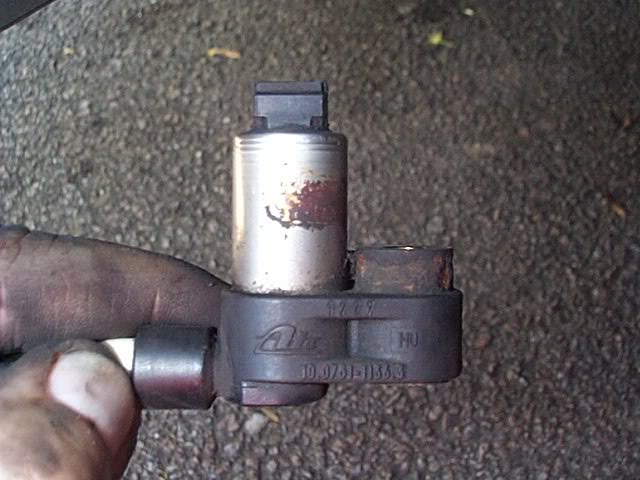

Sensor head. this was chocked full of crap,so i cleaned it up, yet still didn't read anything on the multimeter

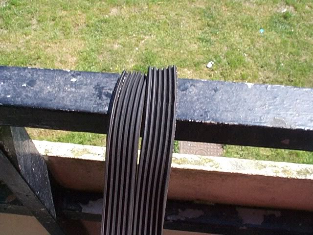

Well my Alternator belt gave up while i was doing the work on this, so my car is now dead
Though me and Andy (Xac) have found out that you can replace the Clutch on the Air-Con pump. so will not have to get a new pump
