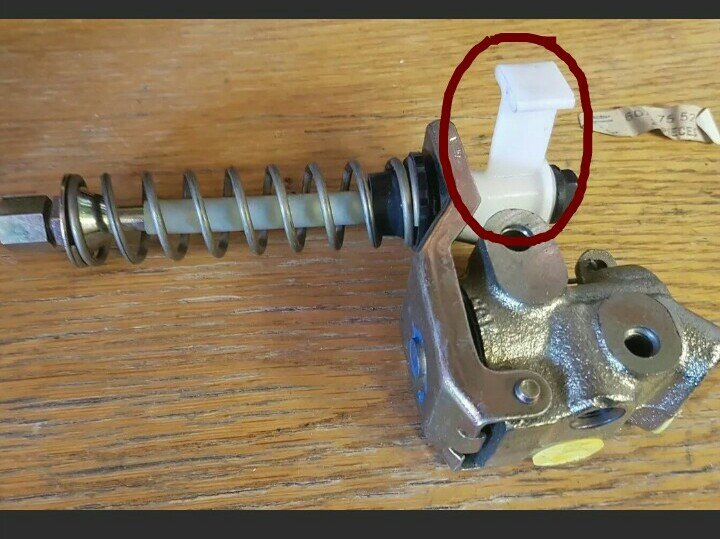

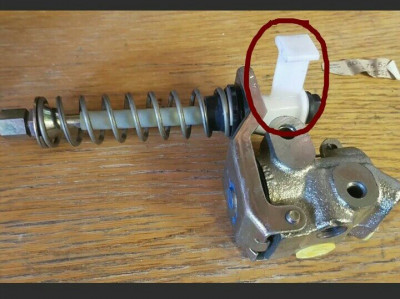

The photo shows circled red the piece that's missing off my sensor
Were the hell will I get one ?

Yours is 486190 which is NFP unsurprisingly... Not enough detail in the picture to see what the nylon bit is about - I rather suspect it might be an installation clamp to hold it closed till you get it on the car.

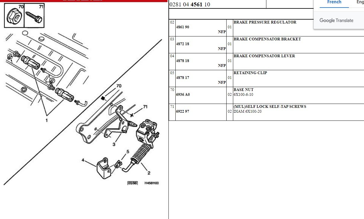

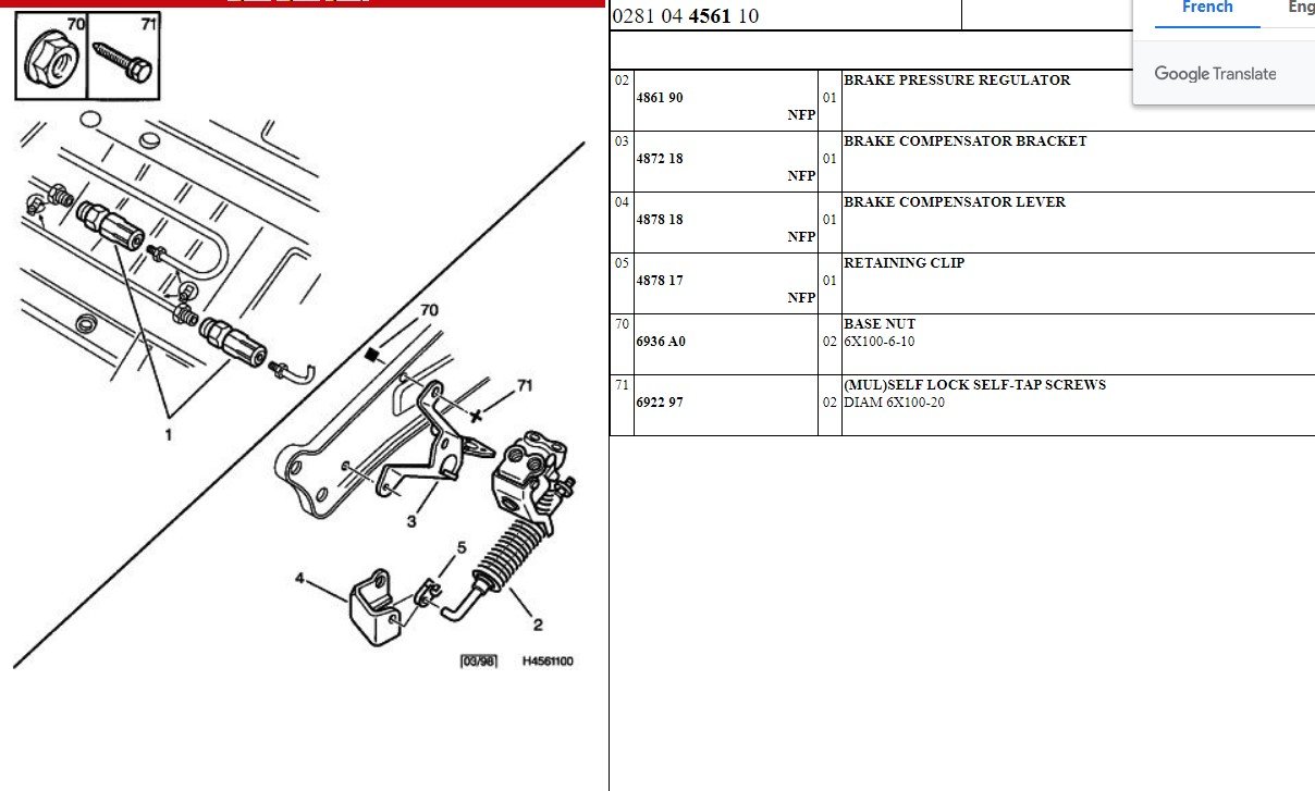

My thinking to, like them bolts in a washing machine drum remove before use.RichardW wrote: 23 Dec 2020, 10:27 Too many zeros in the the VIN, I've updated it.
Get diagram very useful , thank you
