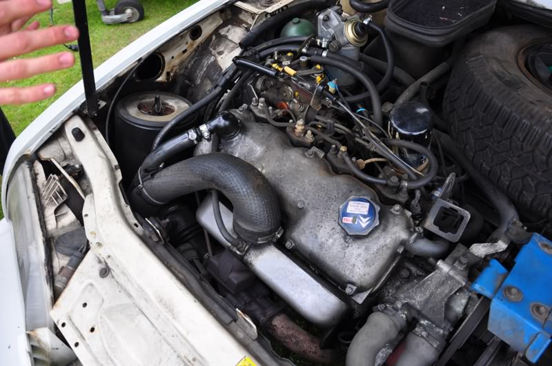

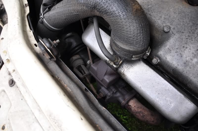

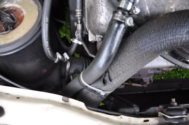

I'm not 100% sure myself Dave (I could tell you about the GTi Turbo differences!) although I know someone that will know - he should be at the X Rally so I'll ask him.
For reference here's a DTR Turbo 2 engine bay overview...
...and here's those pictures that I took for you at last years CXM of that chap's CX DTR Turbo 2 Safari!
If dad decides to go in the DTR Turbo 2 to the X Rally then feel free to pull yours up next to it and compare... I heard you bumped into each other again in Tesco!
