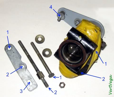

My Xantia had a new clutch and I noticed they were too lazy or incompetent to refit some connections back on their holders so it wouldn't surprise me if they missed something off the pipe too if they had to remove it?
Can someone please identify exactly what should be there and where so I can check mine?

Looking through this i think i may try and leave work a tiny bit early today and get my head under my xantia and check the PR block and all as the engine and box have been out in mine and i have suffered some loose bolt syndrome since the rebuild....

MikeT wrote: Can someone please identify exactly what should be there and where so I can check mine?
I have added numbers but no text assuming that a picture is worth a thousand words :)
Hope this helps someone.

Unread post by MikeT »
VertVega wrote:Hope this helps someone.
Yes it does! Thank you very much VertVega. It'll allow me to check mine asap - when it stops peeing down that is.

Unread post by VertVega »
You're welcome MikeT :) Mine doesn't have the metal sheet seen on the left (3 holes). This part was from a newer model ('99 or '00)
Warning, will be a little bit Image
This regulator is from a scrapyard where I personally removed spheres. Nice training for a beginner. Regulator came as a freebie as well as some pipes,clips.
Personally I had NO idea about the price of a regulator (neither did the salesman I guess). Some weeks ago I have seen the price on eBay :shock:.
That's a spare part now. I have wrapped hyd fluid holes, That's why it looks like an Egyptian Mummy :lol: Sphere hole was also wrapped, taken off for photo.
