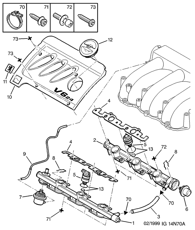

I'd still be tempted to get hold of some spare injectors - like these http://www.ebay.co.uk/itm/Peugeot-406-3 ... 3389faef68 . If you take the car off the road you only need the specialist to find one of your injectors beyond repair or there be some other problem, and you'll be kicking yourself for not having spares. If you send off six spares and there's a duff one, then you can sacrifice your car for a week whilst one (or maybe two, just in case) of your originals is sent for treatment to make up the six. The other argument is if you get a cheap set that are still in their rails (as I did) then you can happily flush out the used rails whilst the injectors are away being treated, and assuming they all come back without any problems re-insert them into their original rails and just swap the complete sets over in your own time - that way the job is a lot less messy and time consuming. The added bonus is the option of re-selling your unwanted injectors on Ebay to reap some of the cost back.
Is that definitely the rail for the ES9J4 from a 406 D8 or could it be from an ES9J4S in a D9 ? I can't seem to match the part numbers they quote against those in service.citroen.com. If its the correct engine I'm strongly tempted to snap them up for that price. :shock:
I would just swap over the whole rail including injectors and fuel pressure regulator and see how it drives - if it fixes the problem job done, if there is still a problem or the problem changes I could send my original injectors away to be cleaned as originally planned, but at leisure without taking the car off the road.

Mandrake wrote:Is that definitely the rail for the ES9J4 from a 406 D8 or could it be from an ES9J4S in a D9 ? I can't seem to match the part numbers they quote against those in service.citroen.com. If its the correct engine I'm strongly tempted to snap them up for that price. :shock:
I'll reply to your other comments tomorrow. :)
ES9J4 injectors are here - http://www.mrv6.co.uk/peugeotpartscatal ... 14N70A.HTM" onclick="window.open(this.href);return false;
These are the injectors for the ES9J4S:
As you can tell, they're different. The interesting thing in that Ebay link is the plenum chamber is still attached - strangely, this might prove helpful. If you buy the set of six gaskets required for the six valve ports then you won't even have to disturb any fuel, other than at the connectors. And while the plenum chamber is off you could have a look at the elusive knock sensor and tell us all what it looks like... Hint hint... :rofl2:
EDIT - I found another set of injectors still in their rails - http://www.ebay.co.uk/itm/PEUGEOT-406-9 ... 5aea3745dc

stevieb wrote: They're different. The interesting thing in that Ebay link is the plenum chamber is still attached - strangely, this might prove helpful. If you buy the set of six gaskets required for the six valve ports then you won't even have to disturb any fuel, other than at the connectors. And while the plenum chamber is off you could have a look at the elusive knock sensor and tell us all what it looks like... Hint hint... :rofl2:
Thanks for confirming they're different - now I've seen the ES9J4S rails they're clearly a totally different design and thus I can tell from the photo that its the right one.
I've just snapped those rails up so they're mine now. :twisted:
I just realised I can do an injector balance test (with my pulser/exciter tool) and also test the fuel pressure regulator (as well as checking for general leaks) without fitting the rail to the car - all I need to do is attach it to the snap on fuel connectors on the left hand end of the rails and put it over a catchment tray. Then I can have a fair idea of whether there are any iffy injectors or a balance problem before fitting them to the car.
I also have a spare fuel pump so I could in theory test it completely off the car with the fuel pump sitting in a bowl of fuel and piped straight to the rail with a couple of short lengths of fuel hose. :lol:

Anyway, enough ranting from me. Today's update is a simple one - cold start outbound journey = smooth, quiet, with good mpg. Return warm-start journey = slightly rougher, louder, and slightly worse mpg. I'm definitely suspecting plugs, so I'll get them changed asap and report back on my findings. I may do the ICV reset before tomorrow morning's 150-ish mile round trip and see if it helps.
