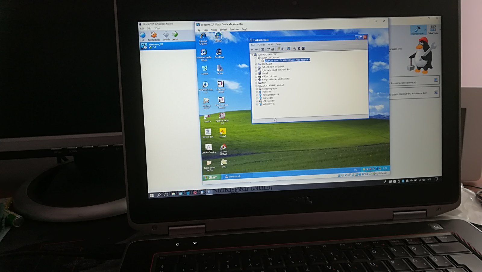

Tornado wrote: 25 Feb 2018, 14:30 Hi guys,
I ordered a Lexia from e-bay and I have the same problem with it as in the video.
Someone knows how to fix it? Or the unit is may be defective?
I have/had a similar issue with the VCI not activating correctly ( green light goes off after 3 seconds instead of giving three flashes then staying on), in my case it was the USB driver kept going back to "utms" (or something like, basically the default driver as the laptop comes with), whereas the install instructions showed how to get it to change to "multi instance". I'm afraid I forget exactly how one updates the USB driver to this multi instance mode, but the solution for me when I got it working seems to be to use the same port for the VCI every time. I taped off the other ports on my diagbox laptop so there's no chance of plugging into the wrong one.
Unsure whether that'd be any help to you, but it's been working for me on my eBay kit so hopefully it's similar.

ekjdm14 wrote: 27 Feb 2018, 17:19
Hi,
Thanks for the tip. I tried both, but unfortunately it was not good.. I have the USB Com Board Evolution Driver (Multi-instance) driver on laptop. The problem its the same.
Lexia 3 software give the following error: Communication interface update error
I have a Windows 10 64bit laptop with VirtualBox and Windows XP SP3 32bit on it.
x 6953
Re: Merged Lexia & Diagbox threads
That might be your problem - using a VM to run this older software that needs access to the Evolution USB drivers. Your VM may be using a standard USB driver and that is not working as it may be overriding the Evolution driver.
I personally wouldn't even consider using any VMs with Lexia / Diagbox and certainly would not use a 64 bit OS - there are too many variables to troubleshoot when things go wrong. A cheap 32 bit laptop running Win 7 will do just fine. Trying to get this running on a 64 bit OS with a VM is just introducing too many variables and makes troubleshooting a much harder job.
Unread post by MikeT »
I have and can successfully run diagbox on my 64-bit Win7 system using Oracle VM.
Sadly, I can't determine and therefore advise why yours isn't working fine like mine does.
x 6953
This is the issue Mike - I think the different VMs out there, the different OS and the compatible drivers being passed through are just extra hassle to troubleshoot.

GiveMeABreak wrote: 28 Feb 2018, 11:16 That might be your problem - using a VM to run this older software that needs access to the Evolution USB drivers. Your VM may be using a standard USB driver and that is not working as it may be overriding the Evolution driver.
I remember reading about just such an issue a good way back in this thread (I think it was).
Definitely would advise getting a cheap old 32 bit Win7 laptop to dedicate to Diagbox, mine cost all of £25 on ebay and even has a good battery despite being listed as not having! And 100% would recommend the first job on receiving said laptop should be to do a factory reset, it made my install so much easier once i bit the bullet on that rather than keep struggling with the laptop as it arrived. (even though it appeared to be a "clean" windows install, i guess it was old and had remnants of deleted programs confusing it and slowing it down)
