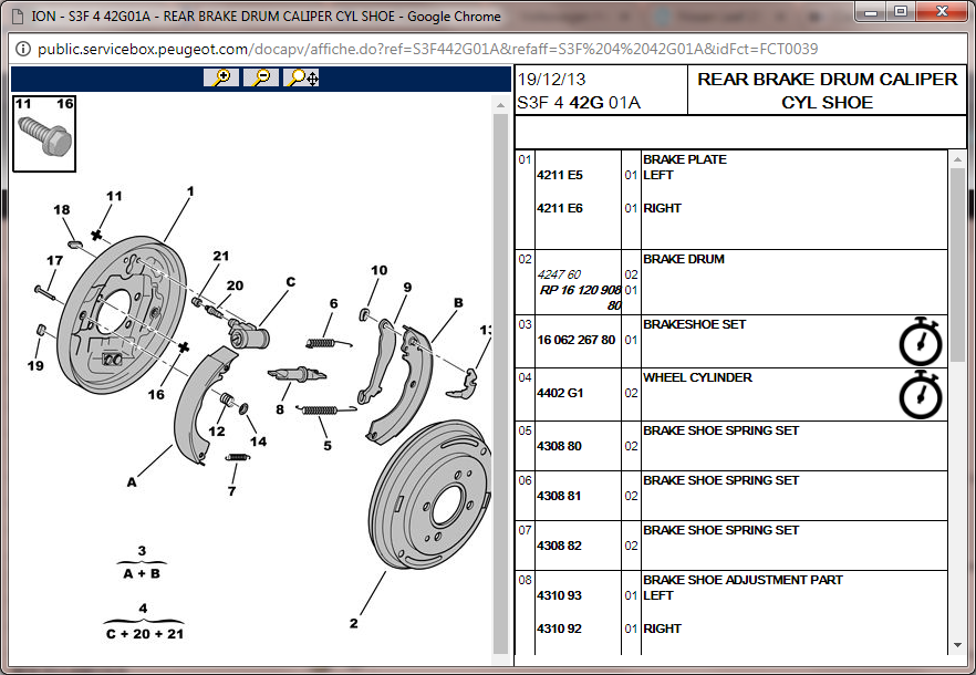

Haven't heard of that before... although I have little experience with drum brakes. How would I know ? Can you tell from this ?

Difficult to say conclusively from the PSA image.

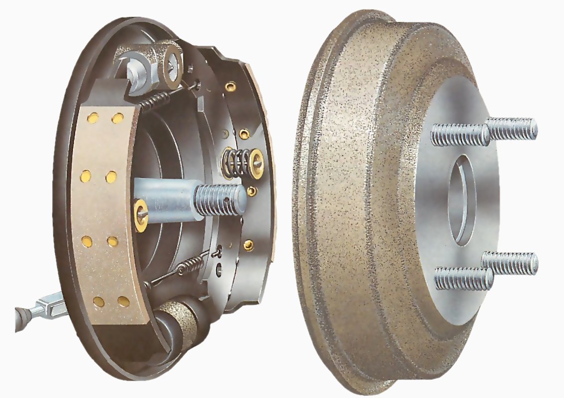

A brief description of the two common ways for brake drums to be attached to cars.
The good old fashioned way is for there to be a hub with the wheel studs or threaded wheel bolt holes firmly attached with good old fashioned wheel bearings on to the axle. The brake drum is then passed over the wheel studs - or lined up with the bolt holes - fixed with one or two grub screws, then the roadwheel is bolted on and the brake drum is held firmly in place (being sandwiched between the hub and the roadwheel). Easy to service and no great dramas. See picture:
Drum brake, 'How A Car Works' - Fair use.

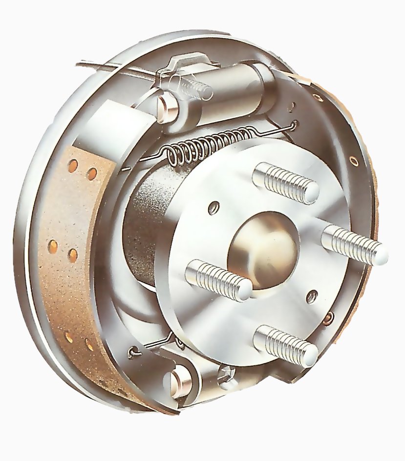

Much more common now there are the wheel bearing-in-drum type drum brakes. The roadwheel bolts / bolt holes are an integral part of the drum and the drum directly takes the load of the the roadwheel as opposed the hub in the above description. The bearing-in-drum type drum brakes basically take the place of the good old fashioned hub, and therefore they have their own version of a hub nut. Normally this would be a large nyloc nut. The issue with this type of brake drum is that you have to disturb the 'hub nut' to get at the brake shoes and/or brake mech.
If you look at the photo below, you can see the how the bearing would sit in the drum, then the drum would be attached to the stub with a nut.
Integral drum brake 'How A Car Works' - Fair use.

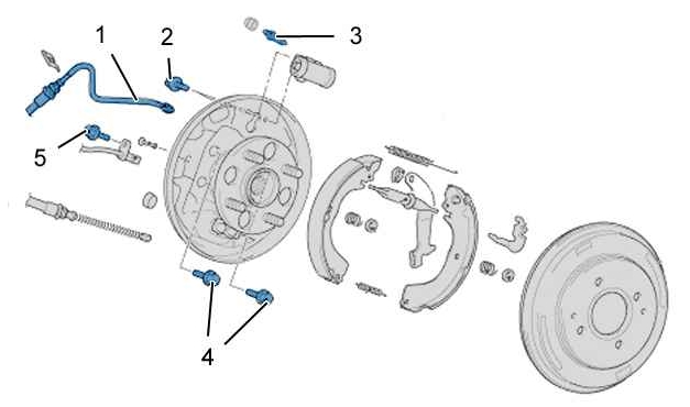

Rather surprisingly, my ageing copy of Docbackup lists the C-Zero, and providing there've been no major changes in the design of the rear brakes since my copy was created, it looks like your brakes are the good old fashioned wheel hub type :)
C-Zero rear hub PSA - fair use

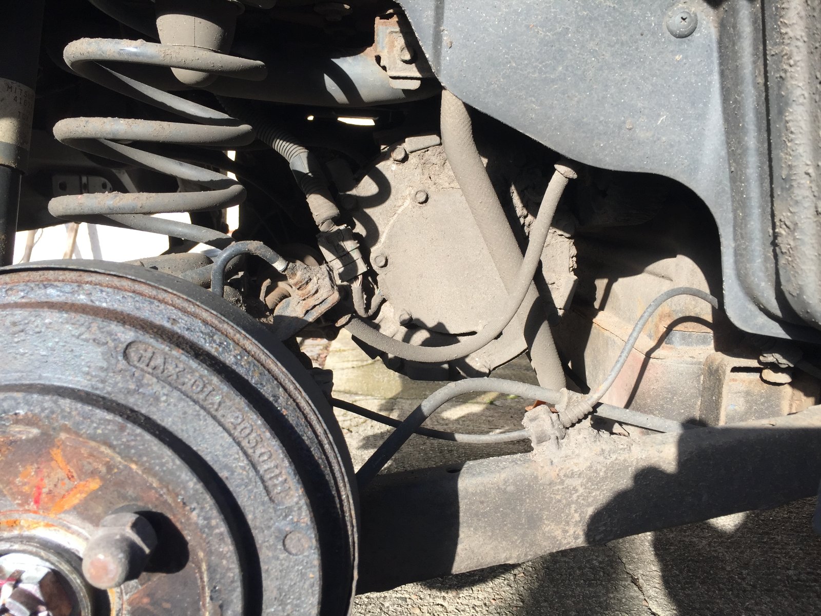

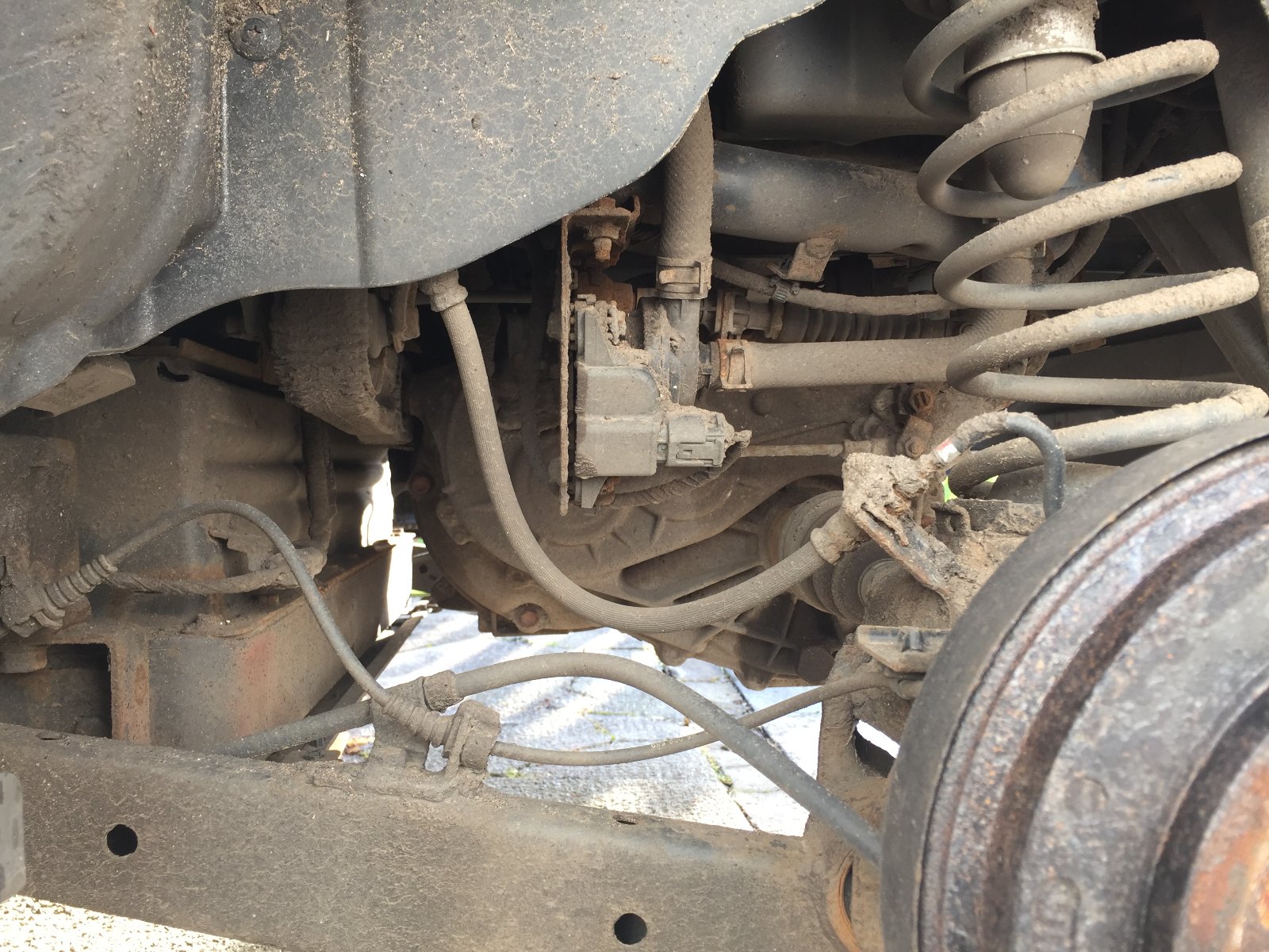

I thought I'd taken a picture of the hub in the past but it looks like I was focusing on what was behind the hub - you can see it in the corner of these two pictures:
You can see the stub axle nut visible, but I'm presuming it's through a hole in the outer hub and doesn't prevent you lifting it off. Is it normally just the tightened wheel nuts that holds the outer drum in place or are there small screws like with discs ?

Mandrake wrote: 05 Jan 2018, 18:16 Is it normally just the tightened wheel nuts that holds the outer drum in place or are there small screws like with discs ?
The parts list has No.16 'Drum Fix screw(s)' listed so it should have a couple of small grub screws holding each drum on.

Simon, I've sent you the PSA docs for the rear brakes - but I see you have another source :lol: . Amusingly the PSA docs say to remove the drum "remove wheel. Remove Drum" No mention of any screws, and I can't see any on the diagram, so it would appear to just 'lift' off. Might need some persuading over the studs if it's never been off. I wonder if you might find a debonded lining....

RichardW wrote: 05 Jan 2018, 21:15 Amusingly the PSA docs say to remove the drum "remove wheel. Remove Drum"
That made me chuckle when I saw it on Docbackup. They might as well say 'Fix the bits you want to fix' :lol:
The p/n is out of shot on Simon's picture extract, but the screws are number 16 as obliquely referenced in the screw shown in the box in the top left hand side.

bobins wrote: 05 Jan 2018, 21:24 The p/n is out of shot on Simon's picture extract, but the screws are number 16 as obliquely referenced in the screw shown in the box in the top left hand side.
It is, but if you look carefully at the diagram you will see the screws 16 shown as going through the back plate holding it on, so the description is misleading... :-D
