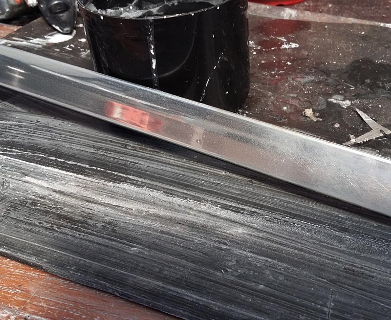

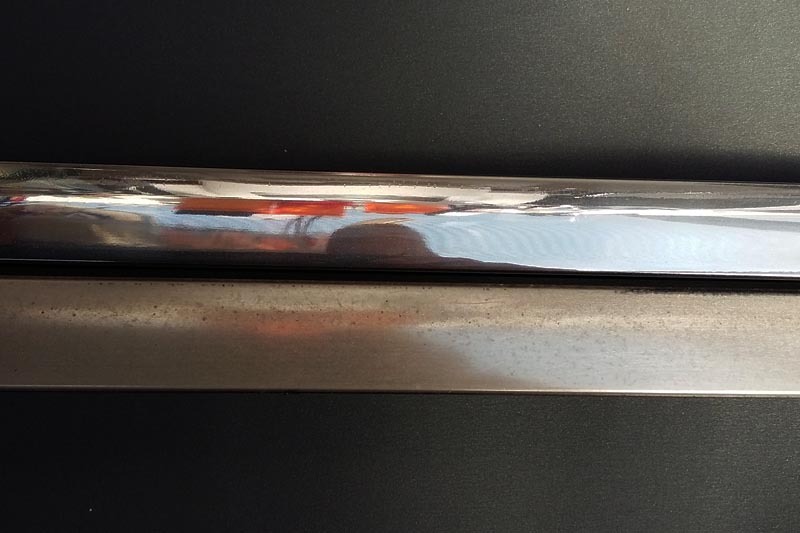

Tried a little "restoration" on the side panel chrome strips
Stage one (untouched to the right, 1st stage "wet/dry" on the left)
Stage two, clear lacquer (Halfords spray can) and a polish....before ANY work below

Use p3000 and work it, do not be tempted to use a coarse grit to start, fine scratches etc will be filled by the lacquer....which I applied in two thick coats and dried in strong sunlight/warmth

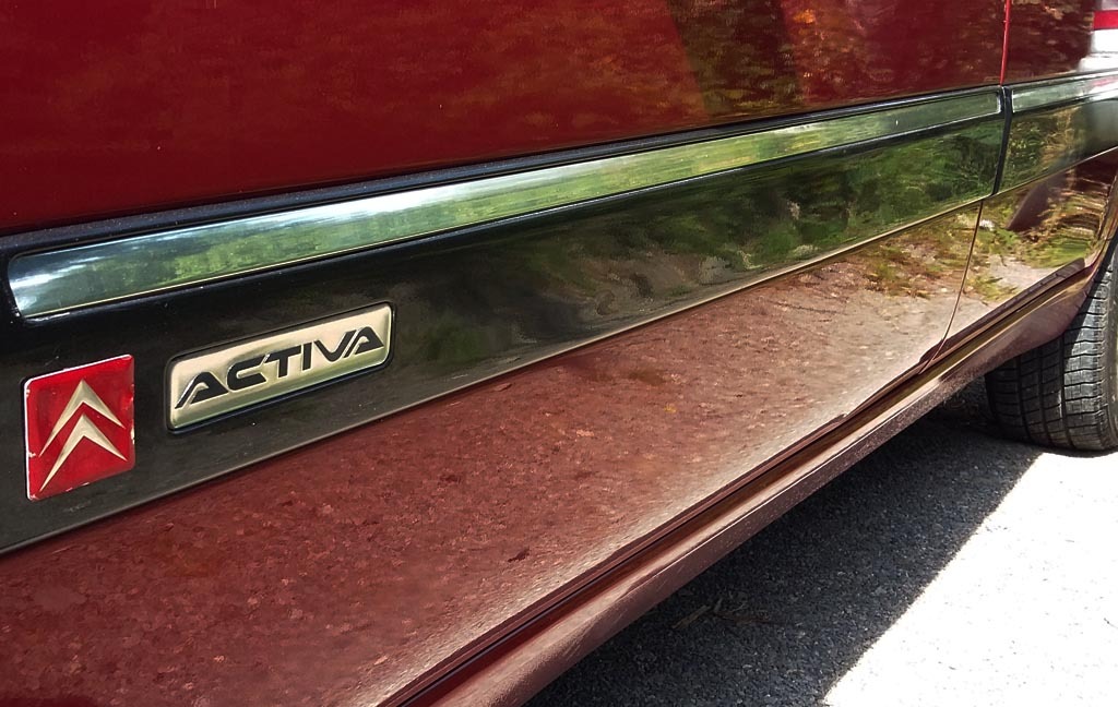

Calling these as done now:
