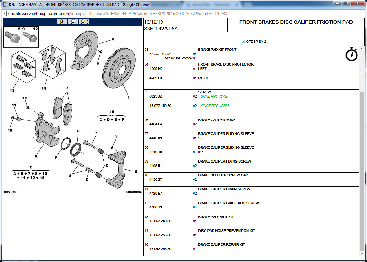

Have had a couple of minor scares with the brakes on the Ion recently... It has taken to the brakes trying to bind when almost stationary. :shock:
For a while now (well before I touched the front brakes) it has had a very intermittent problem where when you are rolling very slowly and apply the brake slightly to come to a rest the car suddenly stops dead as if you had slammed on the brake hard - it seems WAY too sensitive and stops way too abruptly for a gentle press of the pedal. And yet on a following application it will often feel normal.
This has got a lot worse recently, and I noticed it in particular with the snowy/icy weather we've had where I'm trying to stop gently on a slippery road and occasionally the slightest press of the brake pedal was locking one or both front wheels hard causing a brief skid. :?
Then a couple of times I've come to a stop at a traffic light, released the brake and it has not crept forward as it should, when I've pressed the accelerator it's then suddenly let go with a creak/groan.
Finally a few days ago I was stopped at the lights, took my foot off the brake and pressed the accelerator and nothing! I couldn't move forward with full throttle! After it's recent behaviour I knew immediately that the brake was binding and at a green light with a car right behind me I was forced to put it into reverse and move backwards slightly with the brake creaking and letting go and then drive forward. [-X :evil: (I bet the driver behind me thought I was about to reverse into them!)
It would have only been jammed a little but on the Ion the initial torque when stationary is severely limited until you start rolling - if you happen to stop with the wheel at the curb for example - even a dropped curb, it will not climb it from stationary. So even a modest amount of binding could cause it to fail to start moving. I was lucky that going into reverse broke it free as I was stopped in a really bad place to break down...
It seems to be the front right brake and I'm not entirely sure what's going on - either there is a bump in the outer rust lip of the disc that is "snagging" the edge of one of the pads if you happen to apply the brake just at the right point in it's rotation, (thus freeing it by going into reverse) or the swollen sleeve in the bottom guide pin is getting stuck and not allowing the pad to retract a normal amount - or maybe a bit of both!
In any case I can't delay replacing the front discs, pads and pins much longer! As well as brakes locking on when stationary potentially being a safety issue, I'm sure that front right brake is dragging slightly and causing me a significant loss of range that I can ill afford in winter! [-X
The good news is that the Disc/Pad set arrived a couple of days ago so I have that ready to go, and it looks the business. :) However I still need to get the pins, and some high temperature silicone grease to lubricate them as the disc/pad set didn't come with any.
Looking on Service box I'm not entirely sure how much I should be getting... See below:
Items 7 and 8 are the upper and lower pins, and are £5.56+ vat each so £13.35 for two inc VAT, and this would seem to be the minimum I need. But if I'm interpreting the diagram right, the outer concertina boots for the pins are only available as part of kit 15, which is £11.85 a side. Also it appears that the rubber sleeve on pin 8 is supplied both with pin 8 and as part of kit 15 ?
The outer rubber concertinas have been exposed to mineral grease so I'm slightly worried that they might be damaged (although they seemed OK when I checked them) in the same way that sleeve D has gone soft, but I'm not sure if I'm worried to the tune of an extra £23 to get a kit of seals just for those boots.
On the other hand I could get this seal kit 15 in place of pins 7 and 8, which still gives me the rubber sleeve that I need to replace and that is probably all I need, but in that case I'm not replacing the pins themselves - and if they're worn causing the rattle then I may fix the binding but not the rattle!
Another point of confusion is item 14 which is a "Disc pad noise prevention kit" for £10.30, but it's not clear from the picture whether I'd need two of those to do both sides of the car, also there don't seem to be any noise reducing plates like this currently fitted! :?: Again, I'm not sure I want to add another £23 on the bill for something I may not really need.
When I put plenty of grease (the wrong grease admittedly) on the pins last time it 100% silenced the rattles, and when I cleaned the grease out again on the second go at the brakes the front right one started rattling again, so it does seem to be the pins that rattle and does seem like it needs grease to quieten it down.
Thoughts ? I'm dropping the car in to get the air bag replacement done tomorrow so I thought I'd order the parts from the service department while I'm there, hence trying to figure out exactly which bits I do and don't really need...
Regarding the grease - does anyone have a recommendation or link to a tube of high temperature silicone grease that would be suitable for using on the slide pins without damaging the rubber ?
