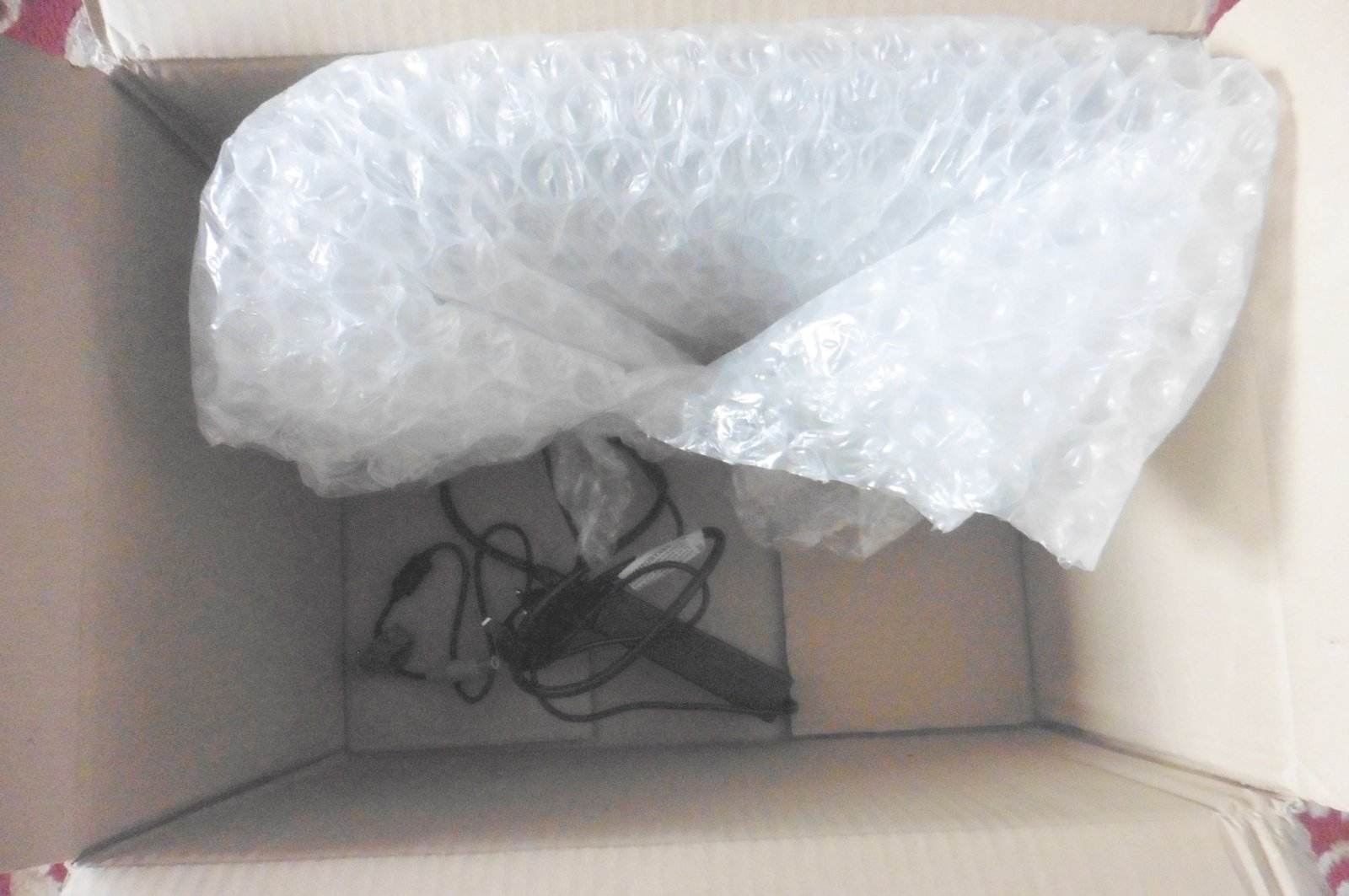

I recently purchased a Lexia with a laptop from an eBay seller, I know Davie had a problem with him.
The item arrived poorly packed and with out the S1278 interface in the sellers picture.

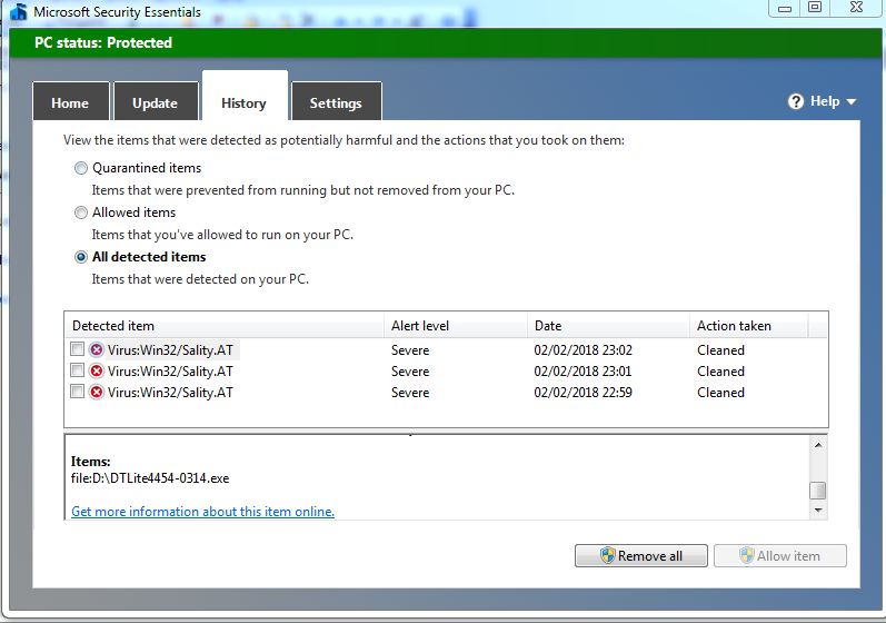

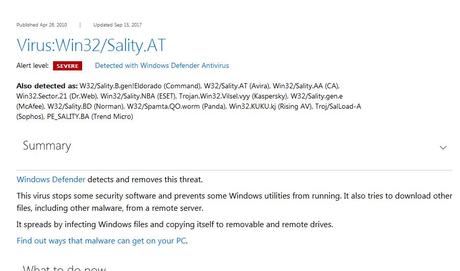

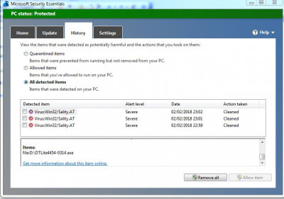

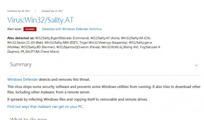

To day I checked the virus program on my own laptop.
I had inserted the CD that came with the Lexia / laptop into my own laptop to read what was on the disc.
It had tried to install so I stopped it, the virus report is attached ?
Some virus reports can be misleading I know.

Re: Merged Lexia & Diagbox threads
Hi Spiff. I have moved your post here into the merged Diagbox and Lexia thread.
That virus warning could of come from anywhere - to be honest and would likely of been picked up and intercepted on the DVD by Windows Defender before it got transferred your PC.
