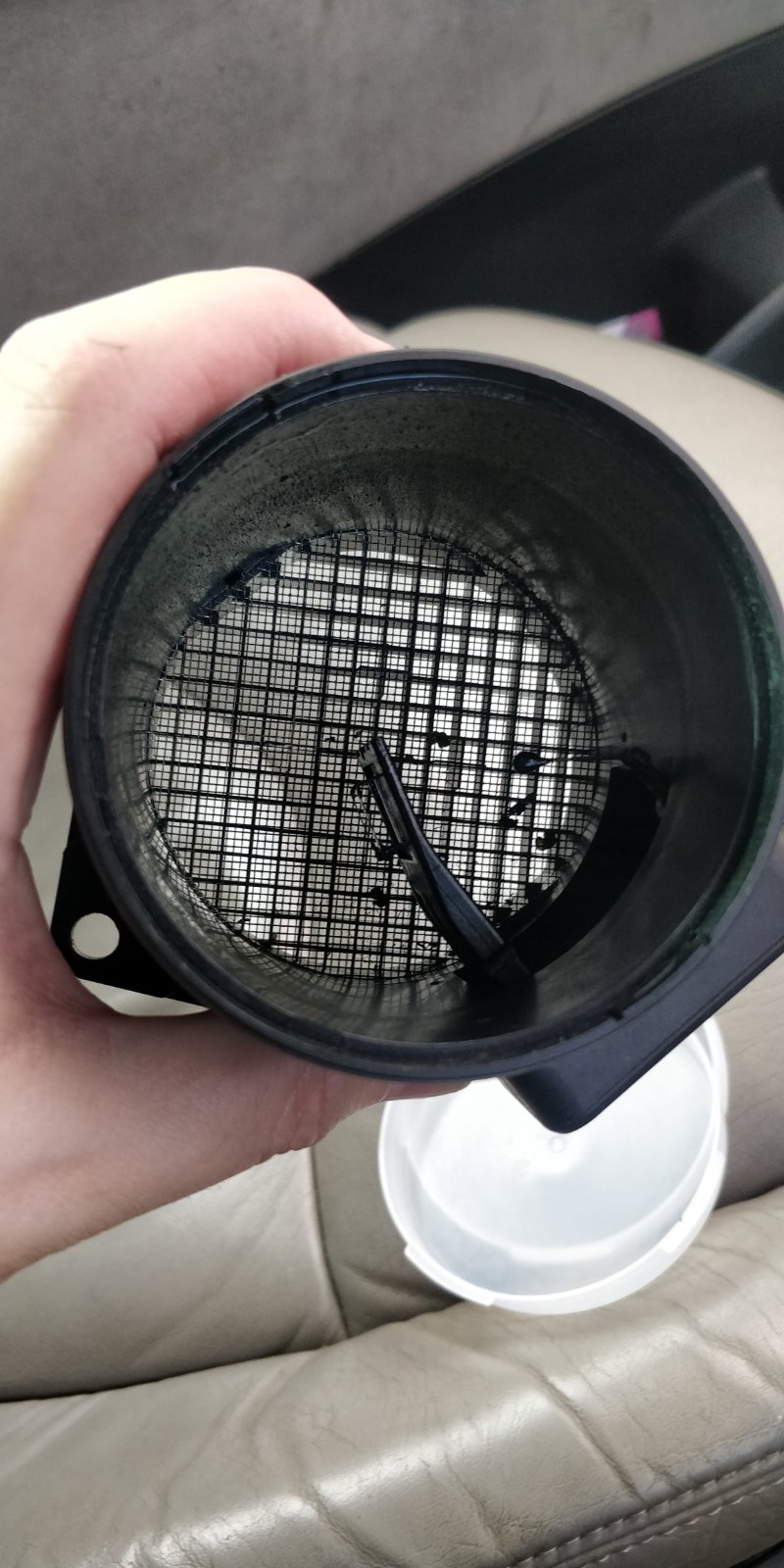

The old MAF doesn't LOOK too bad - not tried to clean it though.
